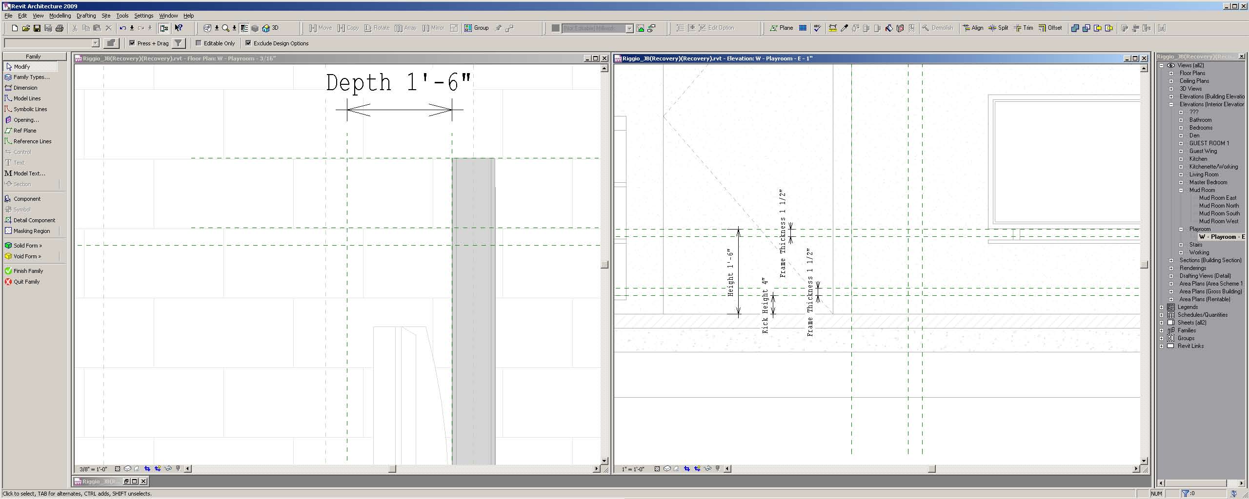

this is a problem i've been having for a few years now. when i start to build a family i try to follow the best practices by creating the reference planes first and then adding the dimensions and parameters. sometimes while i am adding the parameters the wrong reference plane will stay where it is. i thought the hierarchy of reference planes had to do with both their order of creation and whether they are strong v. weak, however this doesn't seem to matter in some cases. am I missing somthing? this has happened since release 9, i'm currently using 2009.
 i would attach an example but the only one right now is an in-place family in a very large file and i'm hesitant to make this a specific issue as this happens across projects and family types.

 maybe my initial question wasn't clear or well written enough. so i'm attaching a pdf to try to better illustrate what is happening.
i know that only reference planes that i have added label dimensions to will flex that is not the issue. the issue i am having is the hiearchy of which they are moving. essentially one reference plane has been locked to a wall. another one should be a distance away from it (offset) and then a third should be a distance away from the second one (frame thickness). the hierarchy should be that the first one stays put, then the second moves according to its parameter while the third one stays with it according to its parameter. but the exact opposite is happening what is more confusing is that on the right hand side the reference planes work fine in a mirrored situation and now after a few minutes of tinkering if i add the parameters in plan it works fine but not if i had them in elevation as they were added on the right side. hopefully this illustrates this specific instance better.

this image is better.

i appreciate the responses and this is why i didn't want to get into a specific instance as i've had the same problem in loaded families.
do you really think the issue is that its an in-place family or do you just disagree with my methodology? i honestly don't believe it has to do with it being an in-place family. why would it work correctly after i've added the parameters in a plan view rather than an elevation view

ANSWER - You dimensioned to the wrong thing.  Plan - elevation - doesn't matter where you label the ref plane location - but it does matter what you dimension to.

i can assure you that i tabbed through to make sure that i selected the proper reference planes. again this doesn't really explain why this would happen in both in-place families and in loaded families. thanks for trying to help. i'm sure it will big a big aha! moment once i figure it out.
