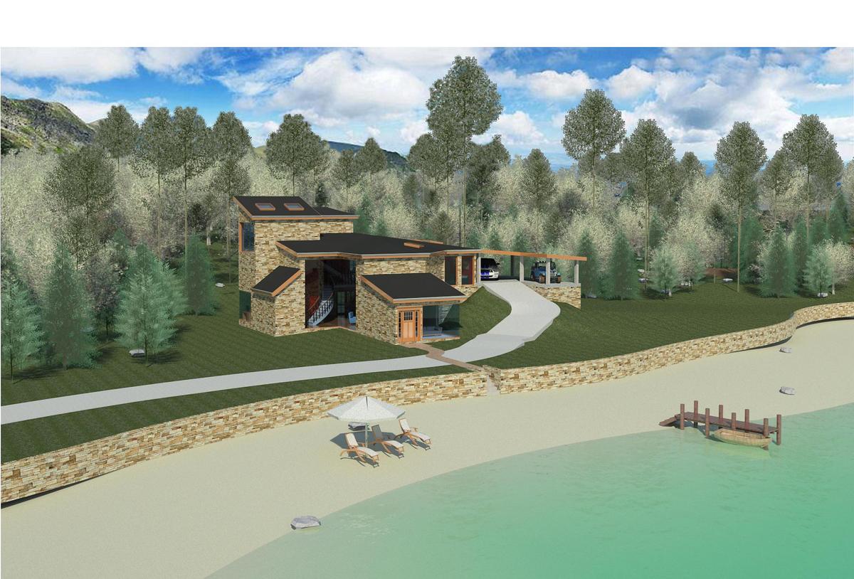

Hi, did you make all of the rendering in revit alone? I like the effects of the clouds. I would like to ask how did you made it. Tnanks!!!

yes this house was rendered in revit. To get a background you must first export the image file as a .tif file instead of as a jpeg file from the rendering dialog box. Then, you must import the image.tif file into a revit sheet such as E4. After that, you import whatever background you would like to have into that sheet as well. Once you have both images lined up as best as you can get them or however you want them, export that view/sheet as a jpeg file. It will mesh the two files together and make a single image. After doing that I touched up the image in photoshop.
