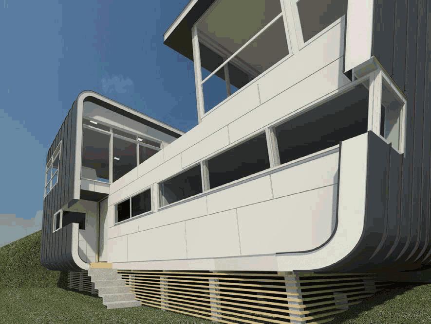

Description: Forced perspective view towards entry - Rendered in Revit using Mental Ray

how do you do the curves on the wall???
plz reply

The roof is an inplace family that is built up as it would be in reality. each layer is a sweep based on the previous so that I only have to adjust the substrate to adjust the whole roof. I have tried to make it as accurate as possible to aid in the documentation.
