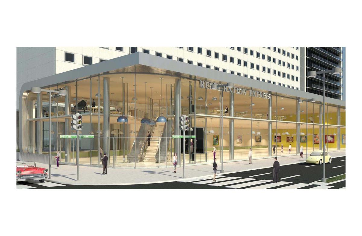

Same questions.  How did you make those street lights, road marks, and street names in revit?

yes same question here also want to know these things?

Hi guys,
Sgreet lights are generic models. Create generic model and separately lighting ficsture family, but just light souse element. Load this light sourse element into generic model. Now you can light your street light. street names is a part of generic model street light. Road marks are subrigion from Site Design bar. Also you can use split surface. Just assign different finish. Glossy paint for example and it would be reflective if you wan to render night view. Good luck.
Tue, Aug 26, 2008 at 9:58:43 AM
AgathaChristy
Joined Wed, Jun 7, 2006
In revit 2009 when your rendering is ready you have an option to export it to PNG file. In photoshop if it is PNG file it backgroung becomes separate layer and you dont need to cut anything. Through photoshop (believe me I used it for this view first time in my life) put stars use brush. Moon is an image (look through extralarge) from Google images and insert as a packground. Good luck.
