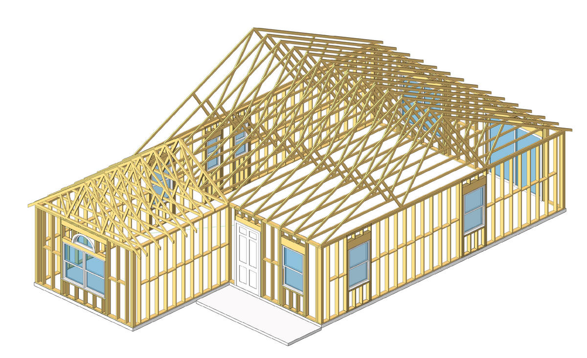

Wood Frame House
Wood Frame House
Uploaded By: Chandej
Fri, Apr 25, 2008
Description: Experiment in Revit

whoa how did you do that? is there an option or is it a family?

Yes, how did you do that?  I could use this in my job .... my bosses would love it!  Nice work.

I created doors and windows family with studs and headers in place. Then filled in space between them with stud wall created using railing.

howdid u get the studs????????
