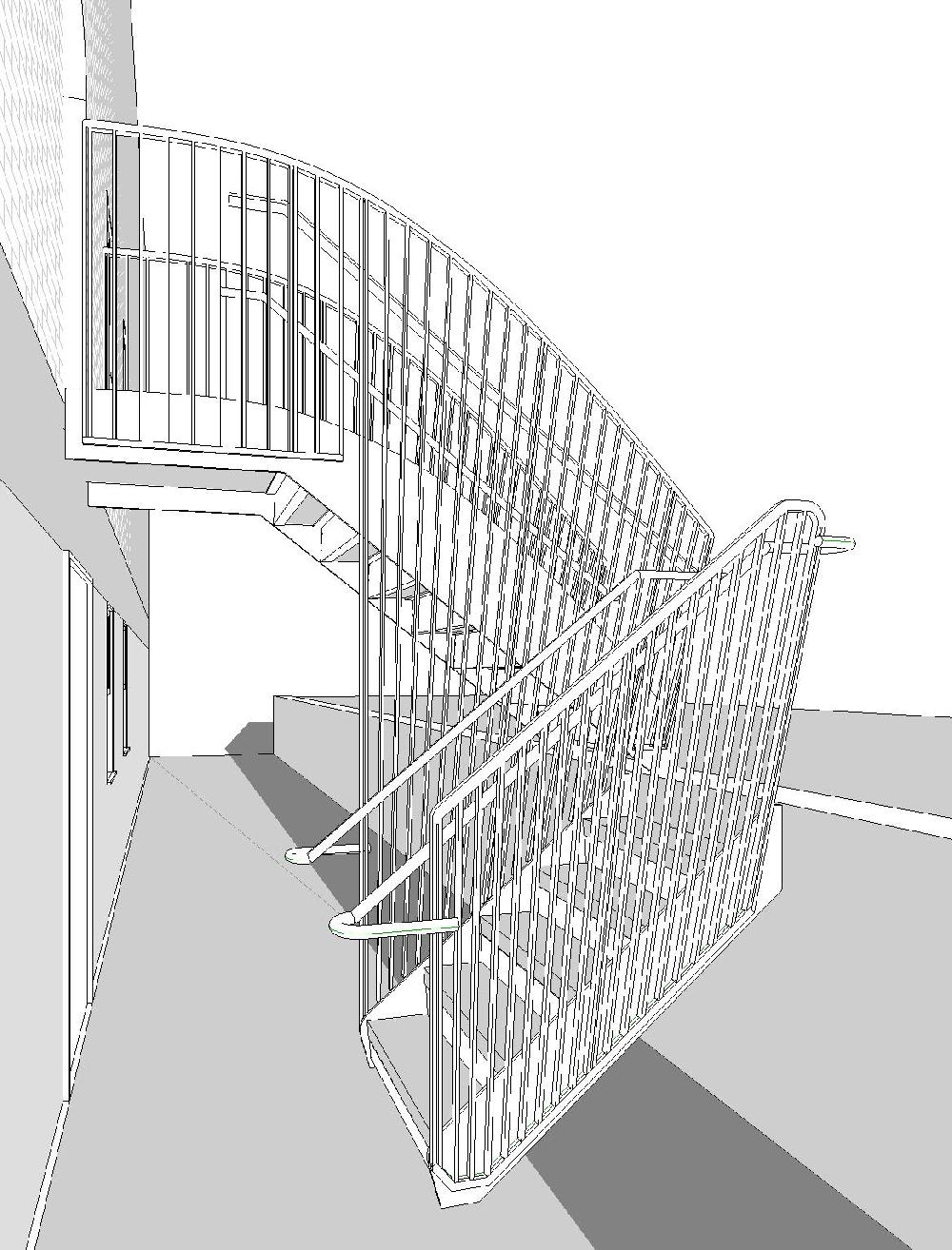

Description: Steel Stairframe from below

Nice work... Interested to hear how you created the railing?

I had drawn the railing [guard] in 2D elevation in ACAD, so when I went to revit, I exploded a DWG block and cut/ pasted the lines into a solid extrusion sketch [using the stringers as my ref planes]. The handrails are just sweeps along a path.

I'm also interested to know if this is all one railing type or multiple types? ... oh nevermind, I just read your reply to Mr. Spot... :-p
