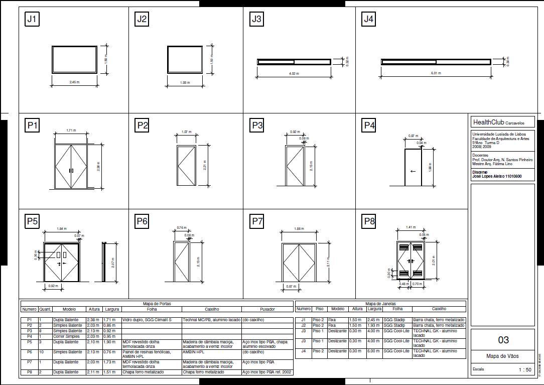

how did you do this? I need help creating a door and window schedule
Thu, Oct 4, 2012 at 5:39:58 AM
ze-la
Joined Wed, Mar 31, 2004
Hi Khalil,
To create a door/window schedule with views, first you create the schedule with the information you need: View > Schedules > Schedule/Quantities
Then you create a view for each door and window using the Legends:
View > Legends > give name and chose scale
- Once you have all the Legends you require, you can insert the objects in each with the views you need.
In a new Sheet you just have to drag and drop the Shedule and the Legends just like any view.

Thanks ze-la for your help.
