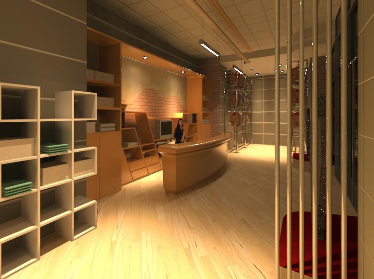

Negozio abbigliamento interno al centro commerciale con revit 2009

hey how did you get your walls to be like that?

I used the wall texture Appiani (Italy) worked in three-dimensional

how to do you get the appiani texture?

You must go to website www.appiani-texture.com/

i downloaded the textures but how do i install them into revit?
all i see are jpeg files!

The textures are all jpg.Crea a new folder and put the new textures. Revit in the allocation of materials, will open its one and then replace the image file with your new folder. This also applies to the  bump. Let me know

sorry i still dont get it. is there like a video or a step by step site where i can see how to do it?

When you assign a new material and go to the "Materials" prey "default", go right to render the composition, where it is written (under the ateprima) generic material property, click the arrow and add color image files. Right click on the square to locate the image folder that you check the texture and material. Same thing you do for the bump. Under theres roughness, click the arrow and add color image files. The procedure is the stesso.Ovviamente adjust the size of the texture and bump as you as you need. Hello
