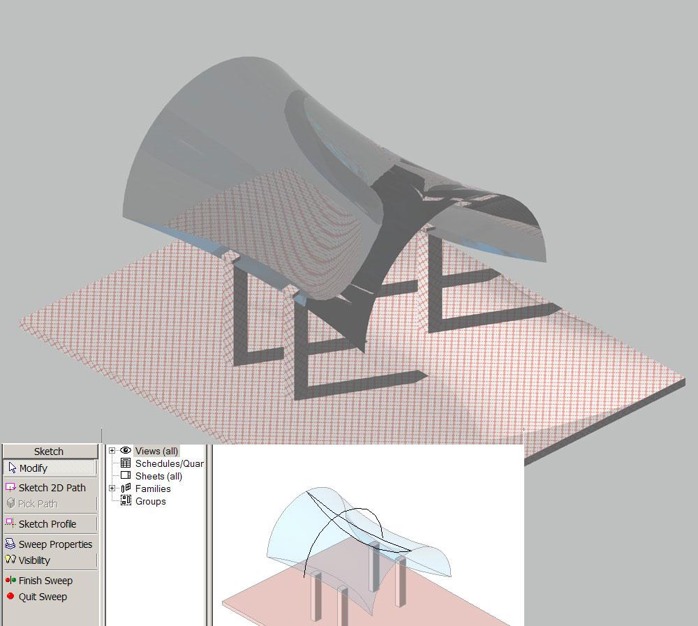

To do it - choose modelling > create > sweep and use a curve for the 2D path and two connected curves for the profile.

DS I forget to tell you that you have to click Solid. So to do it - choose modelling >; create >; roofs Click Solid then choose Sweep Click the Plane-button in the upper left corner Choose Level 1 or perhaps simplier is the 3D-view. And then sketch a 2D path using a curve eg passing through three points. And then sketch a profile using two connected curves for the profile. Perhaps you have to do some rotating too ES Do not forget to meditate on it! so you can loose your I for a moment... and your I will become so much moore creative... and perhaps you can do some Gehry architecture... and earn a lot of money... FS Have a look on this museum for art in Helsinki Finland with some double curves http://www.kiasma.fi/www/viewresource.php?id=3GbyoNKA7QjOa_Y9&lang=en&preview=

Thanks a million Mr GG, this is very helpful to me for a design for a light rail/tram stop I sketched a while back and this is just what I need to help bring it to realisation! (:D) Good stuff and can't wait to see if you show us more of this creative style, It would be a good road to go down, very inspiring!
