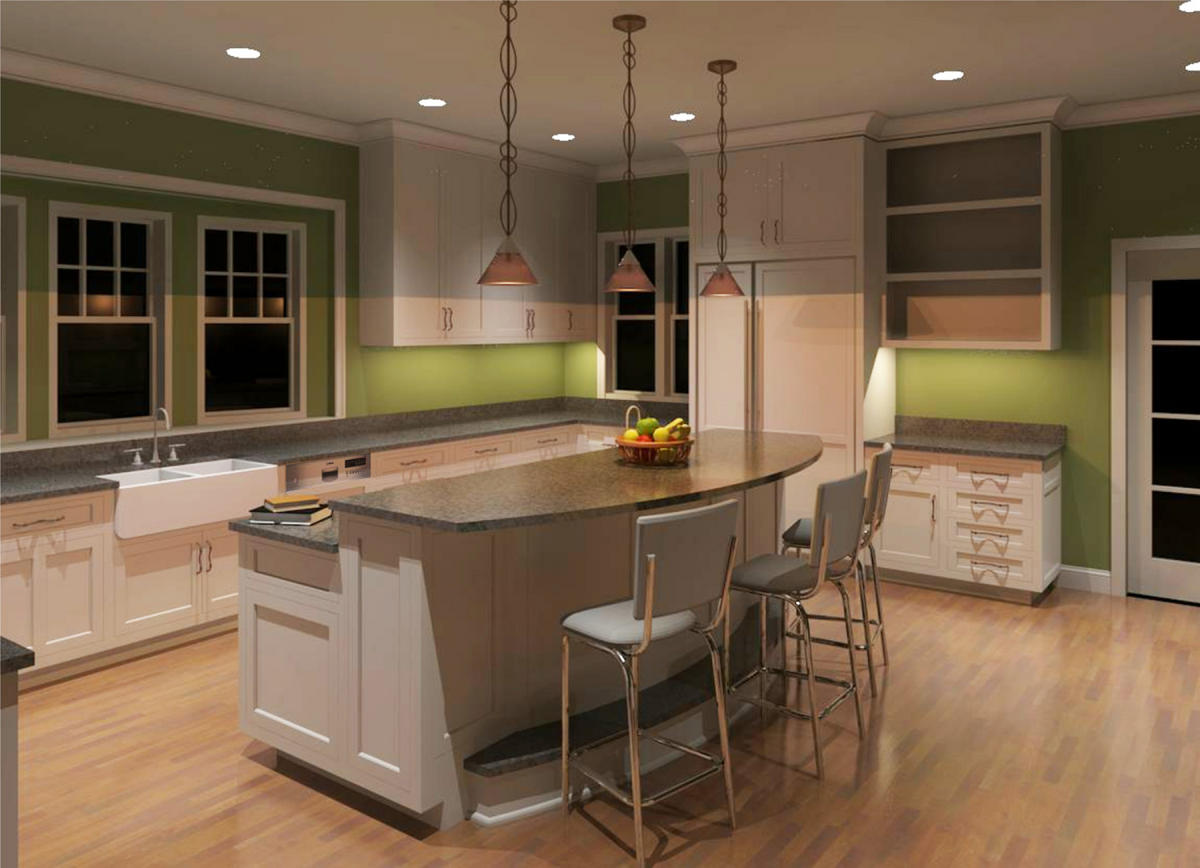

Description: Comments and Criticism highly welcome!         Revit 2010, Render time 6 hours      If anyone can figure out why I have a shadow line at like 7' all the way around that would be great!  I've moved the lights all around and it never moves from that spot.

I’m guessing the cause for that linear shadow to be the three pendant light fixtures, it seems like the shadow height aligns with the bottom of the light fixture. Depending on how this family was created it could very well cause this effect. I don’t have this particular light fixture therefore can’t test this theory however you may give it a try and let us know the results.
I hope this helps any.
Ps. Sometimes I use a studio light on shady areas to light them up. In case you can’t easily fix that; you may use a few studio lights floating about 6’ height to brighten the upper half of your scene.
