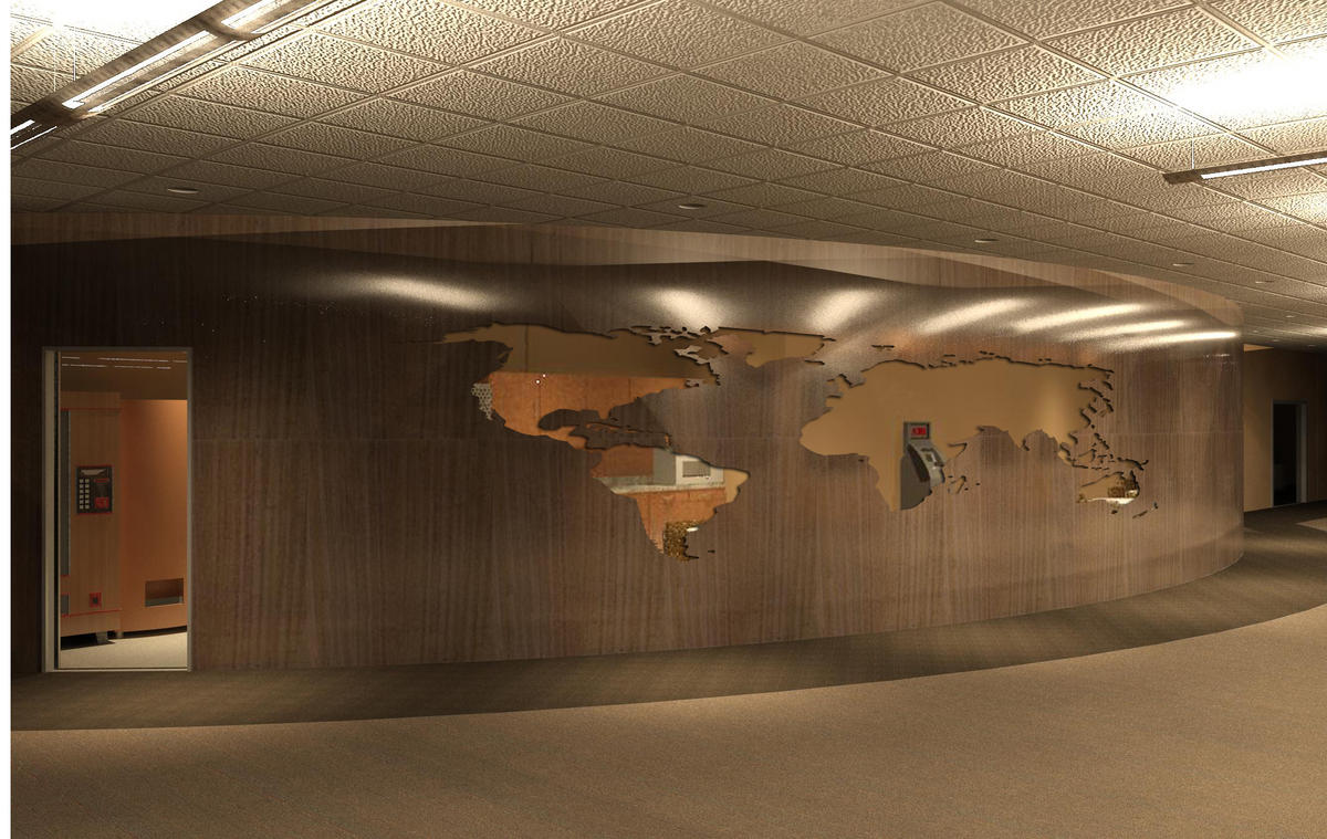

Description: This is my first rendering in Revit.  I still need to work on the lighting.  The wood reflects all of the office lights.

Earth projection! ok now. Tell us please how did you do that.

The earth part was done in Photoshop.  Revit wont allow you to cut custom openings on curved walls.  You can only create square shaped openings.  I rendered the scene 2 times once with the opening and one with out.  I created the cut out in photoshop.

you can cut in curved parts , by voiding the curved part that you wanted to be cutted.
