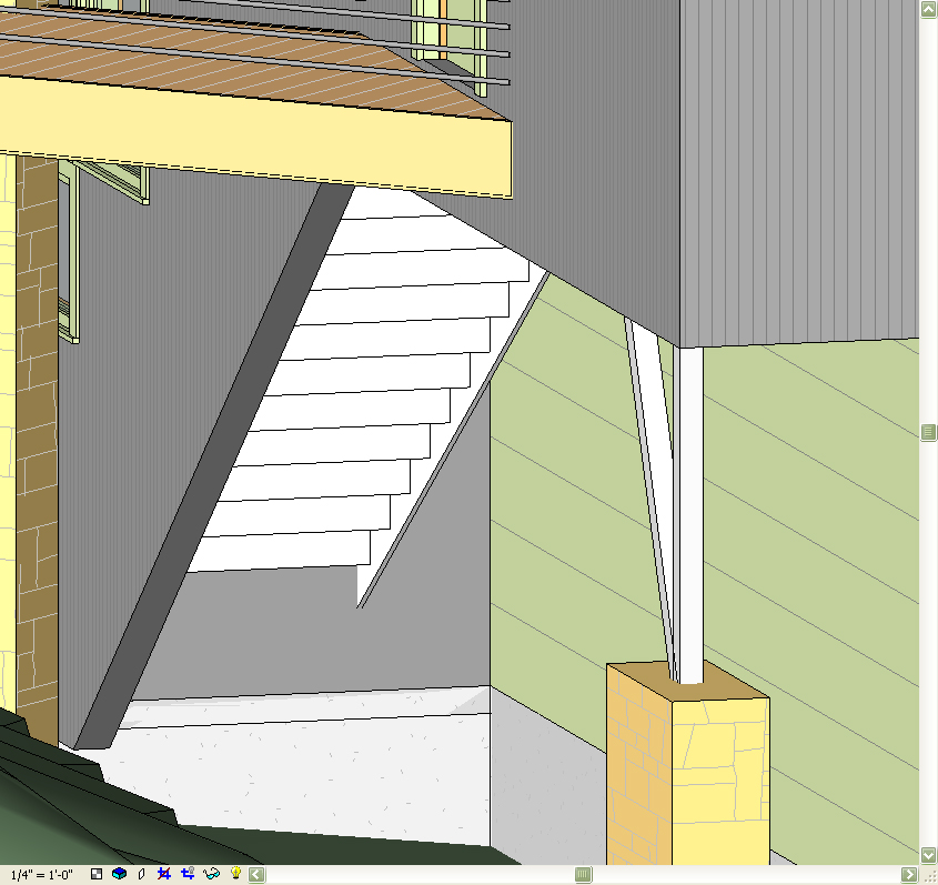

How do I cover the bottom of my stairs so it's just a sloped ceiling?  I don't want the risers and treads to show.
 Ref to image.

You can do this with a sloped ceiling. Create your ceiling, apply a slope arrow. Edit the properties of the slope arrow to the correct head and tail heights.

That worked.  But a little tedious.  Is there no properties in the stairs to just close this?
