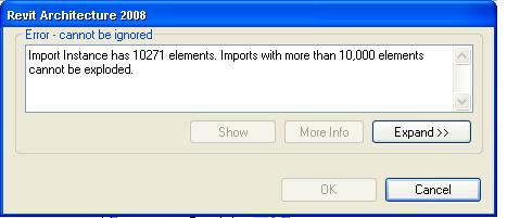

just had a question, i am trying to import a site plan into revit. it's dwg file so there is no problem bringing it in. i tried to partial explode the site, and got this error that there was over 10,000 elements and couldn't be exploded.
is there anyway to get around this?

ARE YOU IMPORTING FOR THE PURPOSE OF MAKING A TOPO IN rEVIT? IF SO, DO NOT EXPLODE, IMPORT INTO A 3D VIEW AND CONTINUE CREATING THE TOPO FROM THE SITE TOOLS AND SELECTING YOUR DWG AND SPECIFING THE CONTOUR LINES...
IN ANY CASE AVOID EXPLODING...
BTW, YOUR DWG IS 3D?

thanks, i tried your suggestions, and it worked like a charm!
