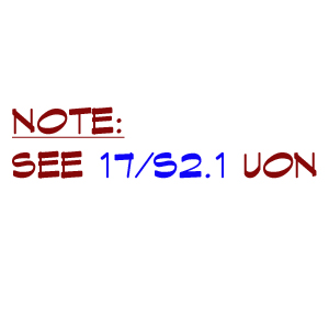

Thu, Mar 13, 2008 at 6:05:15 PM | Bi-directional linking with text possible?
missgayley
missgayley Avatar
Joined: Mon, Oct 22, 2007
36 Posts
hooray!!
i've figured out a different work-around to give me the look i'm after.  i've created a new call out head that is solely labels with a slash of text.
using it in the drawing with the corner radius set at 0" allows the leader & circle to be buried easily in the thickness of the font.  (does that make sense at all??)
i'll add a picture... the red is just a regular text note, the blue is the callout. i've also attached my callout family file
hope this helps!
missgayley
