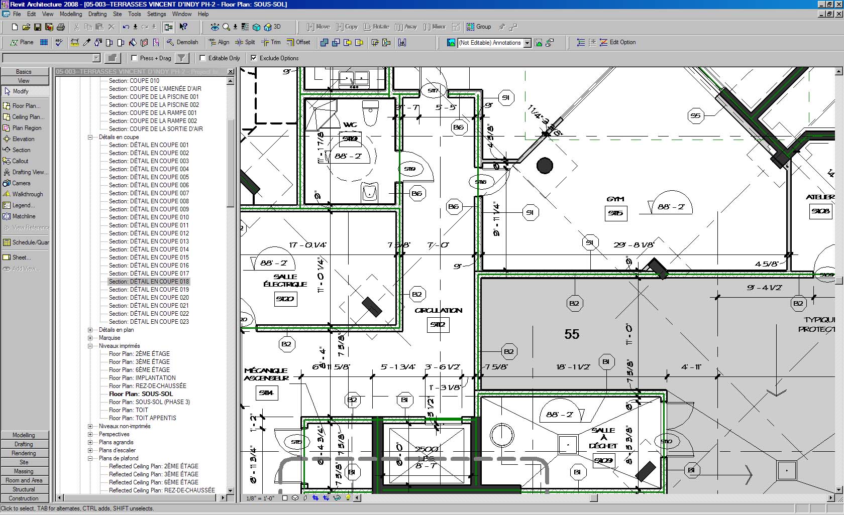

I added a plan region to a view and now I have a green line in the middle of all bearing walls. I can’t change them to non-bearing because I want them on my structural plans. Where can I hide these green lines?

Hover your mouse cursor over the green line, and in the bottom left a description gives a clue as to what catagory you need to switch off, in visability graphics.
Hopfully this answers your question.
