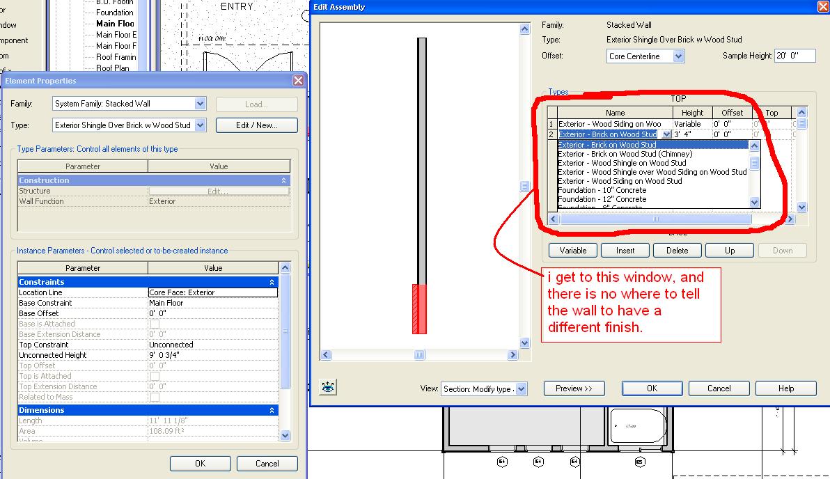

I am getting frustrated with the stacked wall. I have drawn a stacked wall figuring i could just change the finish of the brick to stone, later on. I have gotten to the later on part now, and can't get it to change and can't find any options to change it. I have searched here for a solution, and read a post saying to edit the family. I haven't been able to do that either. Any help would be greatly appreciated.

How many wall types are in your stacked wall?  You must edit each wall type individually.  You can only change the wall types within the stacked wall when editing the stacked wall.

thanks for the reply jon, there is only 2 different wall types in the stacked wall. how do you do that, because the only option when i hit the properties button, and then duplicate the wall, i can still only change the type of wall, not the finish. do i have to edit the family? can you elaborate on the procedure on changing the finish please? thanks

Check which wall family types you have in your stacked wall.  Find those walls (generic/exterior/interior, etc.) in your wall family types.  You have to change each wall type individually as you wish.  If you want to change your finish from brick to stone, then you would copy and rename your brick wall type and replace the brick material with stone by editing the structure of that particular wall family.  After following these steps you will have to change which wall types you want for your revised stacked wall.
 Is that enough info for you...let me know if you need more instruction.

again thanks for the info jon. really appreciate it. I think i finally figured it out. and i figured out how to change the finish, and add my own finish (hatch). My head feels a lot better, a couple hours of banging it against the wall, and finally breaking through the problem, is one of the greatest feelings.

SUCCESS!!!! got it all figured.
