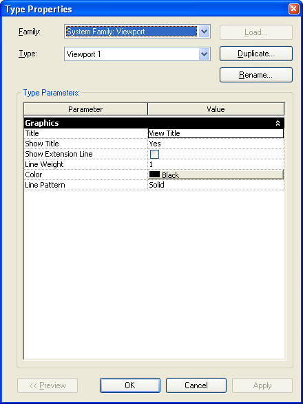

I've read that others are trying to modify the View Title Extension Line, I just want to Delete it. Is this possible? I've edited mine to match our companies standards but the line doesn't show up in my view, but when it's loaded on the sheet, it shows up. Any ideas?

are you talking about an annotation title/detail bubble on a sheet or something about a view on the browser tree? If it is the previous, you can edit it like any family file and load it into your project.

Yes, the annotation title block. The problem is that when i'm editing the family, the line doesn't show up. But when i load it to the project it reappears.

there is a checkbox within the element properties of a view title "show extension line". turn this off.
sorry but you might have to do this for every instance Sad

BRILLIANT! I missed it.
