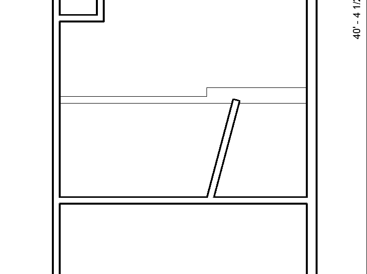

I have been trying to draw a wall with a bump it, where about 5 feet of the wall is 9" thick, and the remainder is 4" thick. I've tried creating an in-place wall, but it doesn't clean-up with other walls, and doesn't have the same properties as the other walls...
 Does anyone know an easy way to do this?
 I've attached a picture showing the in-place wall I created to clarify what I'm trying to accomplish.
thanks for any help.
 jb

I would make them as two wall types. One with the 4" thickness and the other with the 9" thickness and draw them with the faces aligned on the common side.

works perfect. thanks!
