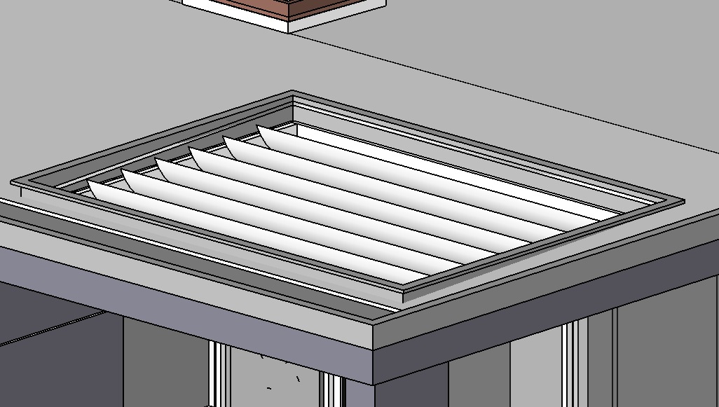

I did this one using a sloping glazed roof item. I use an aerofoil shaped profile with a parameter to adjust the angle. Then create a mullion using the aerofoil, then use a curtain system etc. I only did it once & it worked for what I needed. Check it out... - sorry I am not too sure how to extract the actual model bits out of Revit to share with you!
