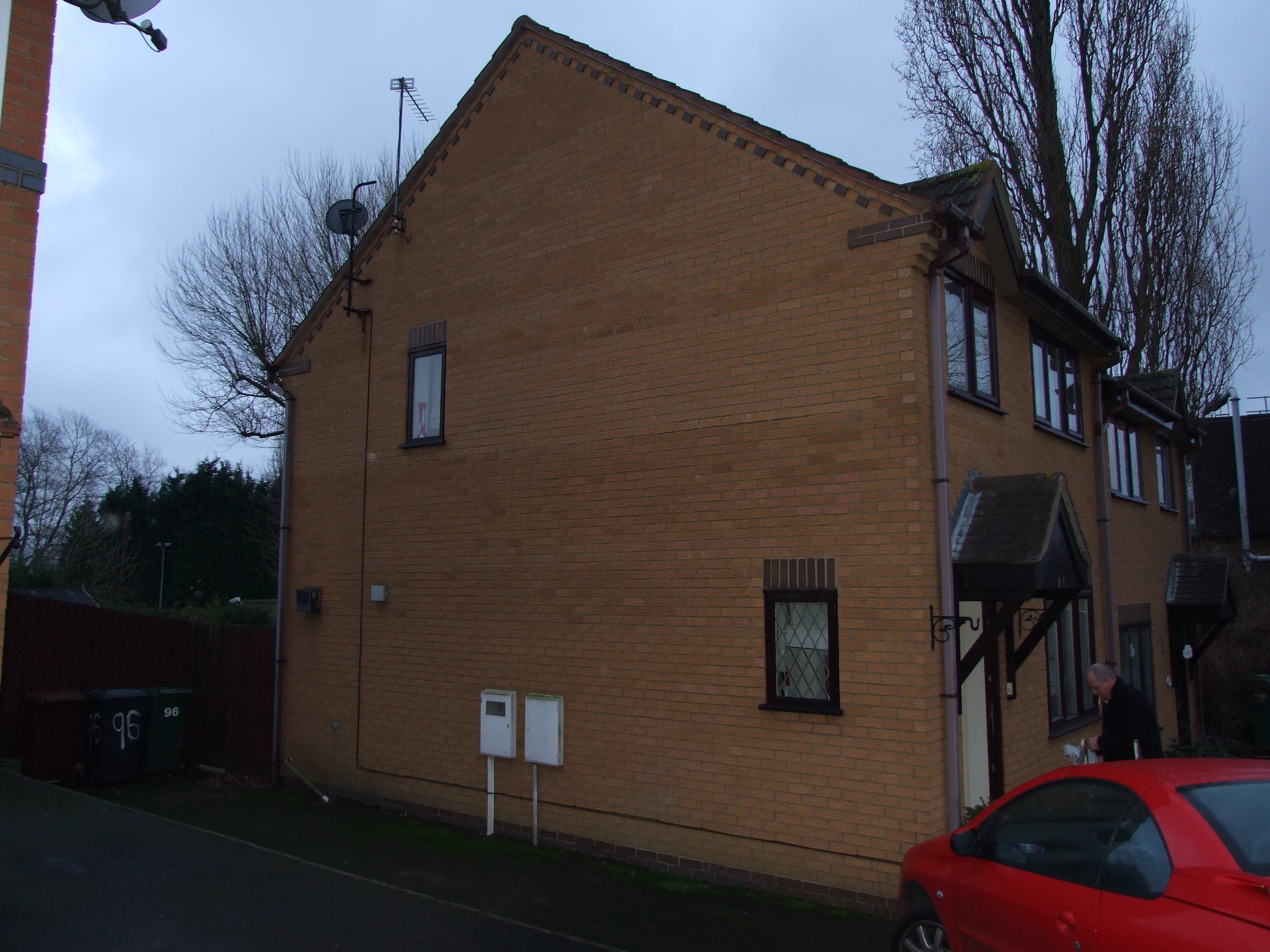

how would i draw the roof detail in revit (the brick corbel)

I'll take a shot at what I think you may mean.  Are you talking about the brick ends that run under the eaves.  Believe it or not, try using a railing.  Search this site under forums and you should find a tutorial for using railings.

the details i was hoping some help on are the brick edging below the roof tiles and the brick pier that the soffits runs into.
Tue, Dec 18, 2007 at 3:18:36 PM | How would i draw this detail in revit?
As I said .... try using a railing.  Check out this thread
http://www.revitcity.com/forums.php?action=viewthread&thread_id=6523

Open the railing project & open your project.  Copy -paste the wall & railing to your project then delete it.  The family will now be in your project.
