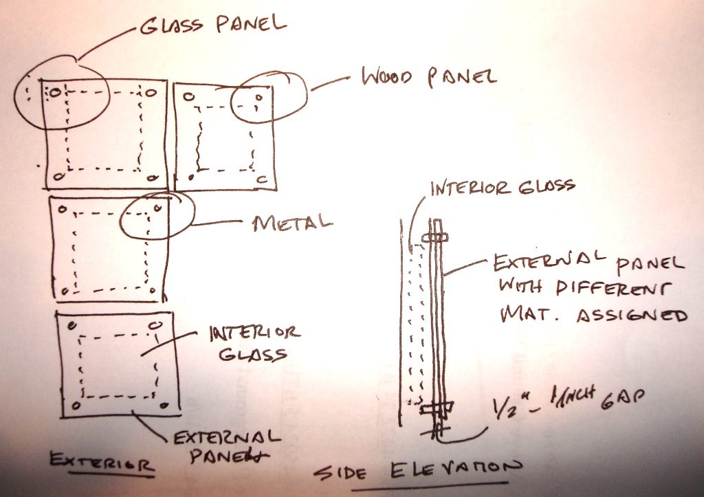

  I am writing because I have been messing with this for the last couple of days, and I am at a point where I need to give up or get some help.  I am trying to make a raised glass curtain wall much like the one found in this tutorial.  The only problem is, I want to assign different materials randomly to the raised panels (i.e. some glass, metal, wood.)  I have attached a sketch of my intentions.  Thanks for any help.

when you make a curtain wall you can change the panels by adding curtain wall grids. then you can hover your mouse point over the wall hit tab so that section highlights then go to your drop down menu above the project browser and you can change the panel to solid or other. then you can duplicate that panel type and change its materials
