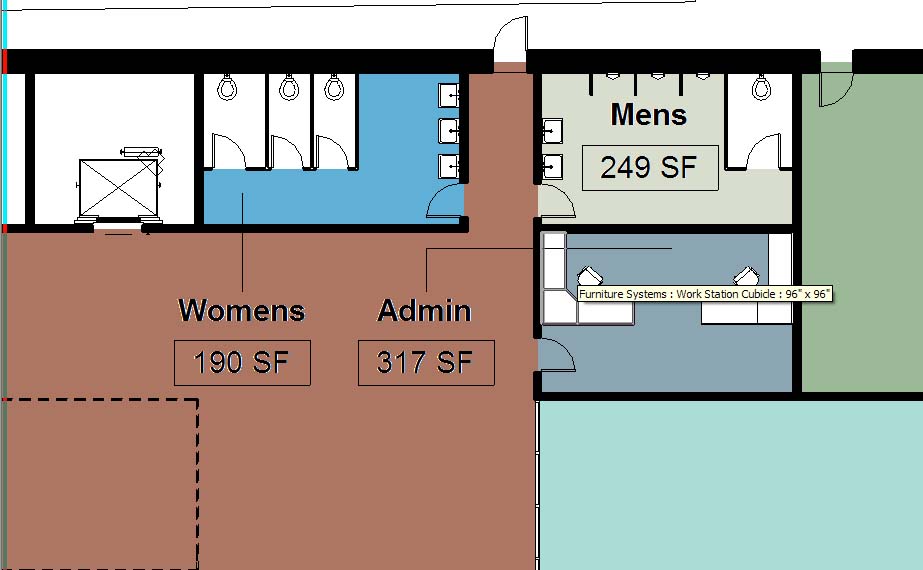

i am having a similar problem. my problem is i want everytihng inside one room to read as one room. for example, in the restroom there are toilet stalls, and i want the stalls to read as part of room but revit sees the toilet stalls as separate rooms because they r separated by doors and toilet stall walls. and for the life of me, i cant get the room separation lines to "cheat" revit.
 do u know how i can get revit to read the whole restroom as 1 room?
image attached, u can see how the womens restroom is not including the toilet stalls in the area sf.

Did you use the "Room Separation" line??? delete the old lines and create the new ones around....

Your toilet stalls are probably walls - right?  Click on the wall properties and turn off room bounding.
