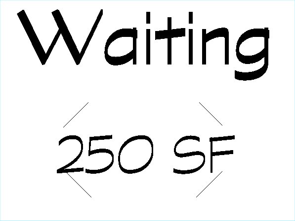

I have phantom lines appearing in a room tag. Attached is an image of the problem and the room tag file.  I am sure there is something simple that I am missing.  Any help will be greatly appreciated.

Good day
I loaded your tag and didn't seem to have any problems with it.  I have attached the image.
I would suggest deleting the tag, purging it from the file and then reloading it into your project because I don't think there is anything wrong with the tag itself.

I figured out the problem with your tag. Open the tag family and go to Visibility Graphics. Go to the Annotation Tab an click on the checkmark that says "Show Annotation Categories". When I did this a set of lines showed up around the room number.
