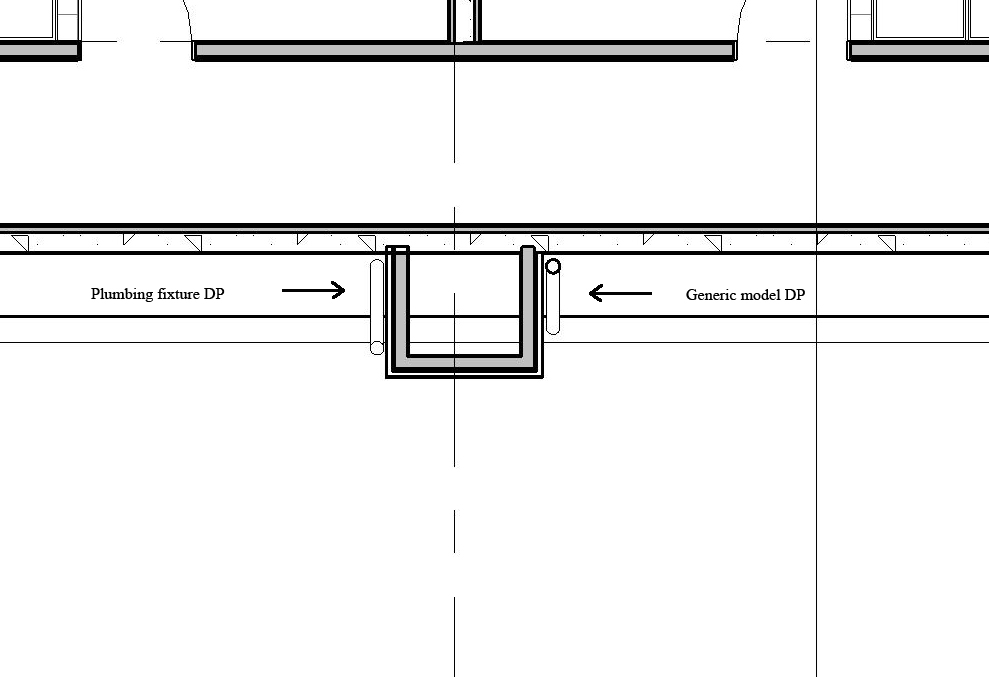

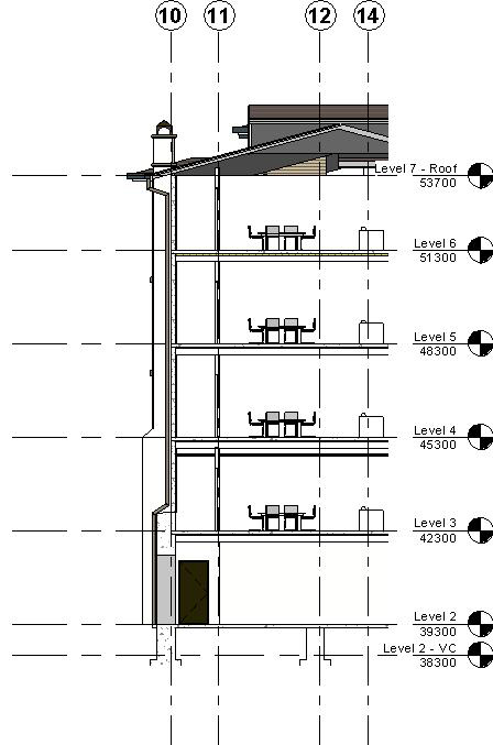

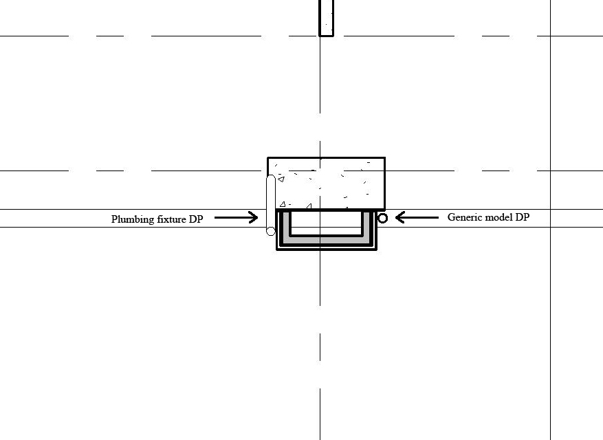

Why is it that plumbing fixtures display differently to generic models? For instance I have two downpipes exactly the same, but one is a generic model which displays in all views as it should, and one is a plumbing fixture which refuses to be cut by any view and instead displays the model in its completeness (see level 1 & level 2 pics attached section dwg diplays how the two DPs look.)

This probably has to do with the family itself.  I think if you compare the visibility settings between the plumbing fixture and the generic model there may be a difference.
The other culprit may be that one extrusion is able to be cut while the other is not, also a "family" issue.
In your help menu look up cuttable families and (under"Family Editor Commands"Winking using symbolic lines.

 aandr001 thanks, yeah that seems to be it. Nothing to be done by the looks of it. Seems bloody stupid to me tho...especially if you have downpipes doing crazy things...
