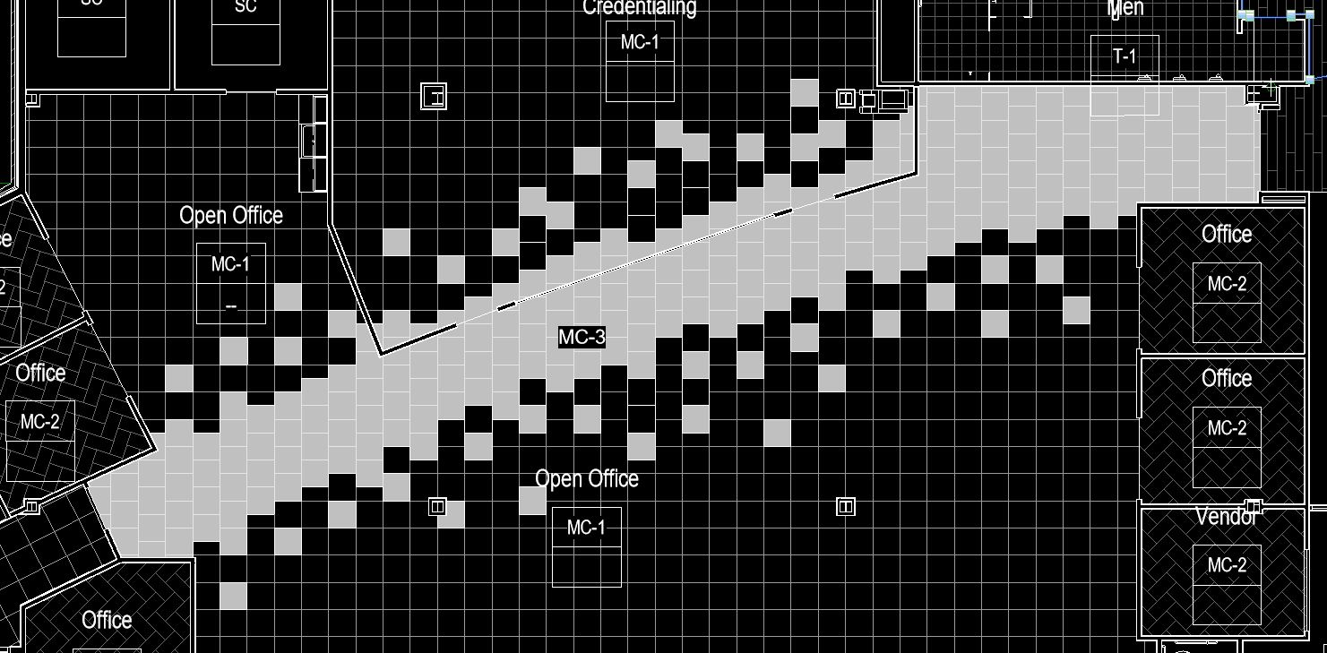

I did this pattern with split face, filled regions, and masked regions quicker than I did it in AutoCAD.
