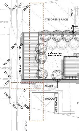

Hi Revit Users,
I have a problem and cannot find a solution on any previous forums posts.
Essentially when I import a DWG (usually the land surveyor's feature survey file) everything is fine in Revit, all the information shows up well; but when I print to PDF (using Adobe or Cute PDF) sections of the text are blocked out (see attached JPG). It is always the same sections within the same project no matter how many different settings I try. It also generally affects text.
 Any help would be appreciated.

Have you tried checking the raster option when you print?

I have received a call from Revit technical support in response to my question and finally an answer!!
 To help others that have experienced the same issue - ensure the box marked 'current view only' is checked when linking or importing a DWG. Then if you need the DWG in other views simply copy/paste as required.
For some unknown reason this solves the PDF 'loss of text' problem...
