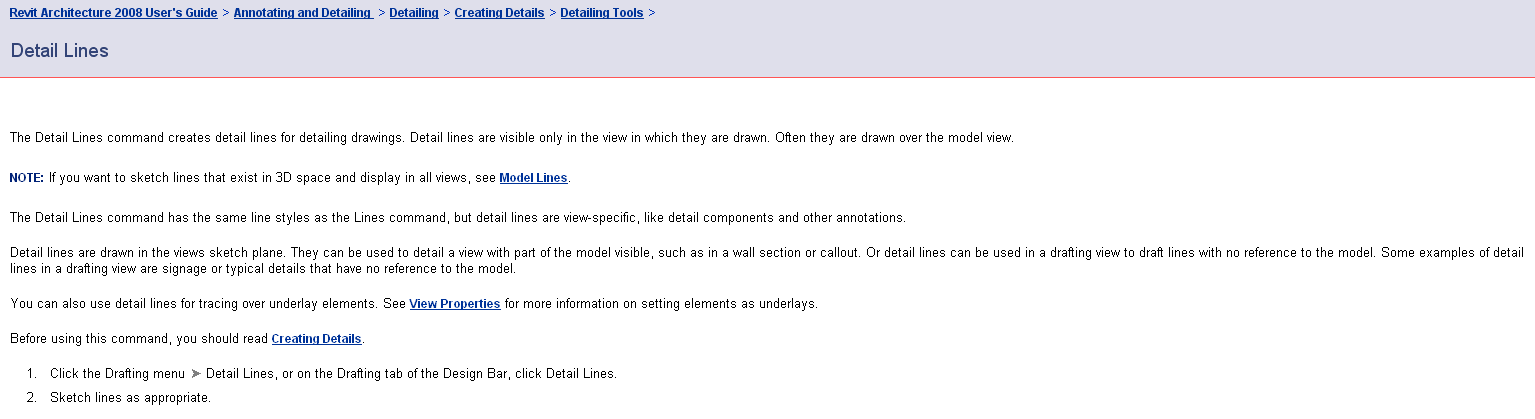

....................they are not nearly as powerful as I would like.  I use detail lines on my floor plan to indicate cabinets, kitchen equipment, and other details.  These are lost in callout plans.  They all come through on dependent duplicate plans.  I would just like to be able to add notes, more dimensions, elevation marks, etc. to a larger scale plan that will "update" if either it or if the original plan is changed.  I can have a different scale on my reflected ceiling plans, why not on "dependent duplicates?"

It is my understanding that Duplicate Dependency was added so that you could have dependent views that maintain ALL properties of the original...specifically so that their scale would change when you change the other and the annotation carries through the two (or more) views. Before them, you could already make independent views with callouts (as ebtaylor mentioned), which is what you are describing sounds like. If something is supposed to show up in all views, it shouldn't be annotation in the first place. We draw things like your cabinets, kitchen equipment, etc. with model lines (or solids or a family version of either/both/symbolic lines/etc.) so that their visibility isn't view exclusive. I think I might be approaching your question this way because I'm selfish. If what I want in my project is a dependent view, I don't want other people being able to override those dependencies with "powerful features"...accidentally or otherwise.

see attached on detail lines. detail lines are similar to annotation, they are only view specific.
Fri, Nov 16, 2007 at 11:11:09 AM | Dependent View Question.
ebtaylor
Joined: Tue, Aug 22, 2006
83 Posts
3 Stars: 2 Votes
about detail lines
