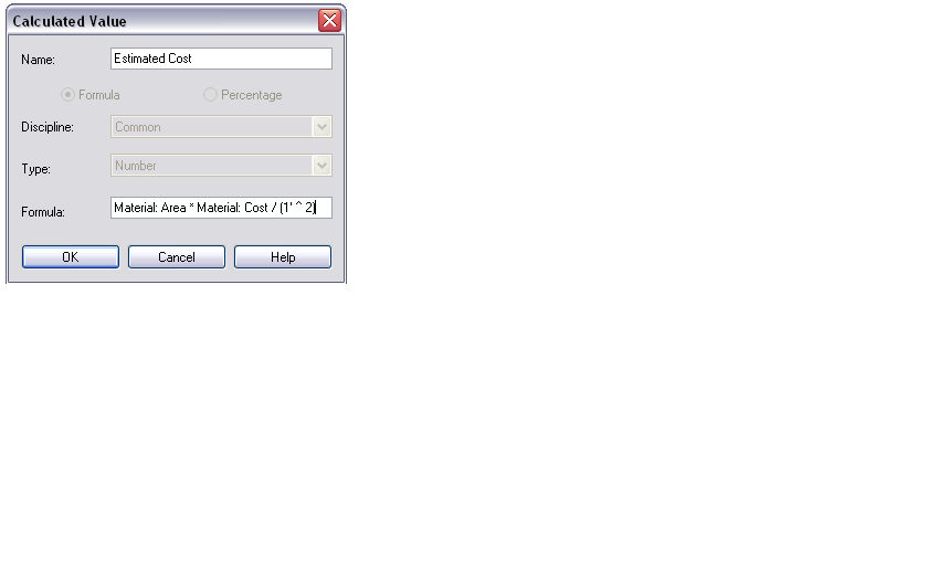

what you are talking, Revit recommends doing it this way:
For Formula, enter Material: Area*Material: Cost /(1'^2).
The /(1'^2) is required to remove the formatting of the fields so the cost estimate value can be calculated.

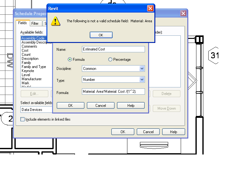

Wed, Nov 14, 2007 at 6:51:30 PM | Material cost per sq ft formula
perthmod1
Joined: Tue, Sep 4, 2007
8 Posts
5 Stars: 1 Votes
When i enter that code into Revit Architecture 2008 i get a invailid message. And which schedule are you meant to do that in?

Wed, May 6, 2009 at 9:16:15 AM | Material cost per sq ft formula
homebrew
homebrew Avatar
Joined: Thu, Aug 28, 2008
7 Posts
5 Stars: 1 Votes
Thanks James and coreed
I was just playing around with both methods and was wondering  why i was getting the wrong answers with the revit Recommended method. the answer was with the 1' in the Material: Area*Material: Cost /(1'^2) . Its Impirial, where as i do not use that so if your using metric the1' will have to be replaced with your metric units, in my case 1000mm. Oh and there is no fullstop in either formula, that got me on both :-/
