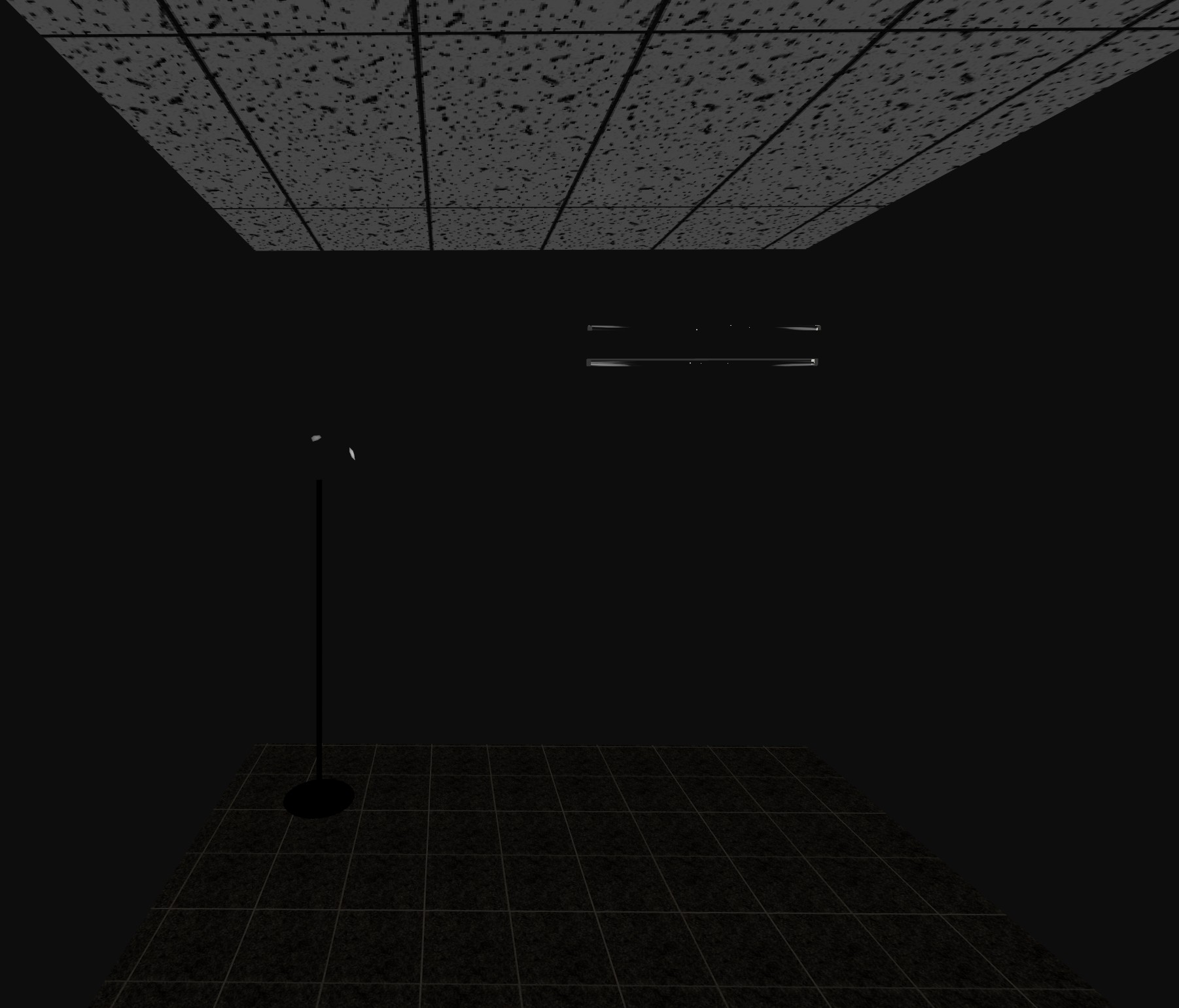

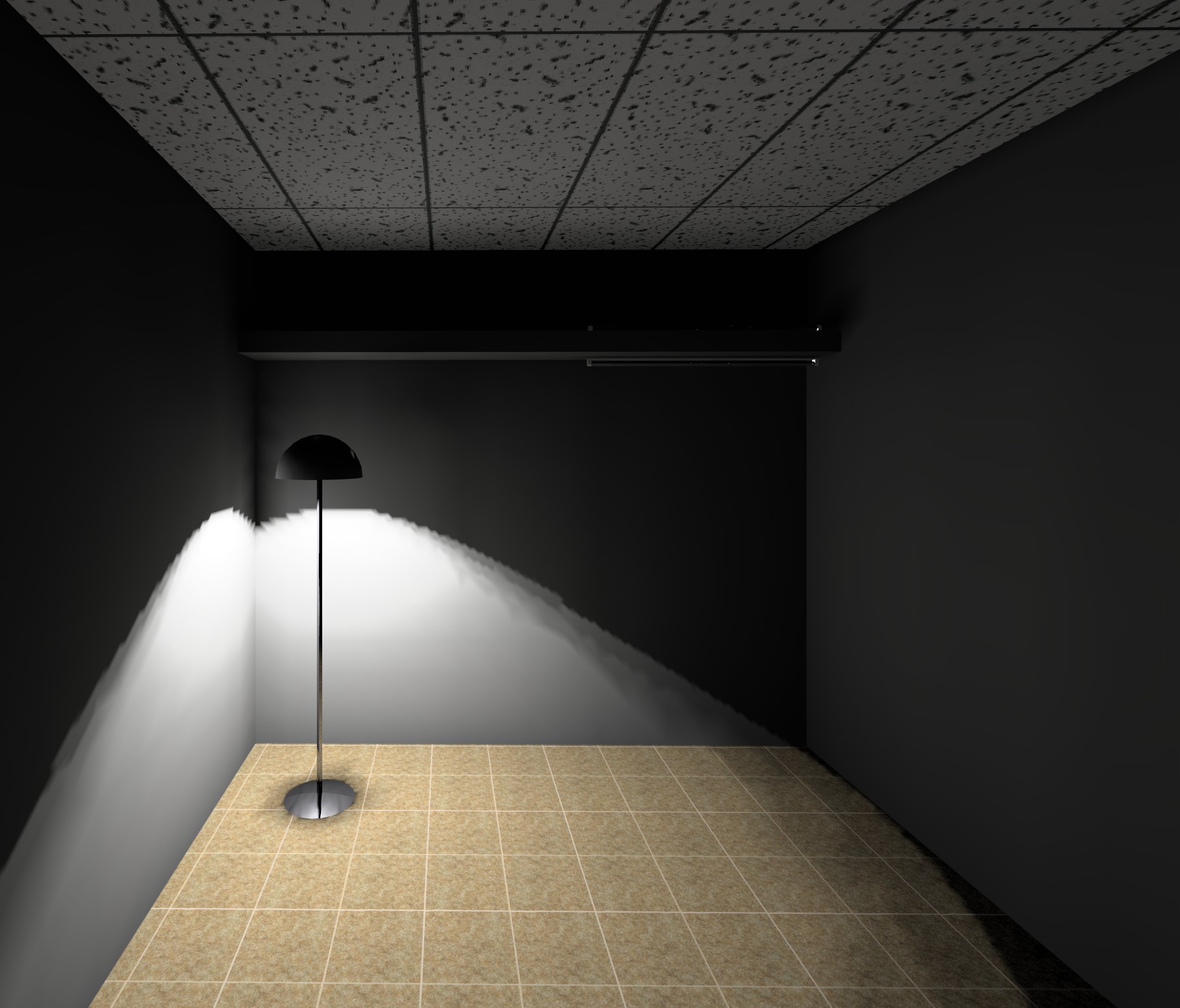

I created a fresh new drawing and created a room with four walls, a floor, a ceiling, a soffit/light shelf, a strip uplight and strip downlight light and a of floor lamp. The two strip lights are free floating in the space just above and  below the light shelf.
I created two scenes. One has all the lights turned on. The other has only the strip lights turned on. Have a look at the attached raster images for the results. What do you think?

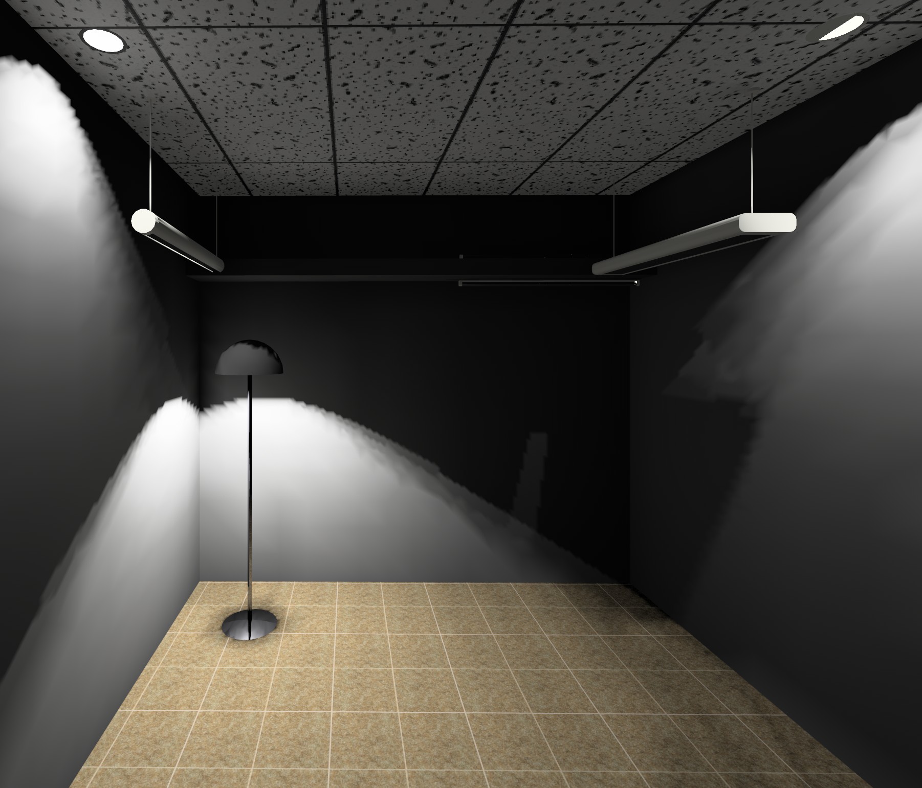

Here is an image with a few more lights including some suspended linear lights, a down light and a wall washer.
For some reason none of the linear lights seem to do anything at all.
Mon, Nov 12, 2007 at 2:04:02 PM | Linear uplights don't seem to be working.
You've got some bad families and it appears they come thay way from REVIT.  If you open the family and look at the "bulb" around the light source, it is not transparent and it has to be.  You need to correct the materials in these bad families.  I would set them to the same material as is in the families that work.
You can do this at the project level by changing the materials there.  On the uplight, the material is glass-white high luminance - change that material to transparent and the light should work.
