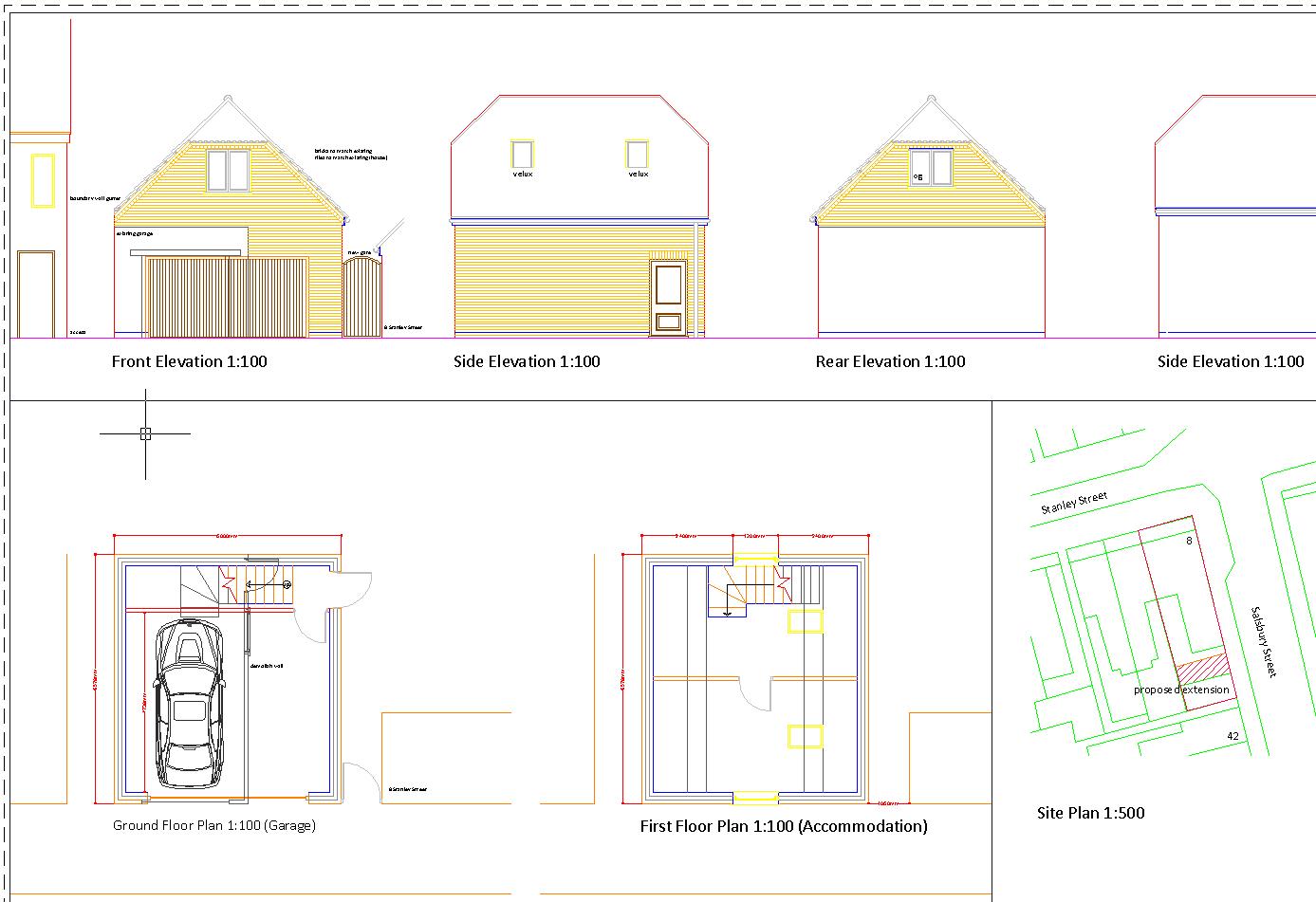

the attached image is a typical planning drawing i would do in autocad, what im wondering is.
when in revit, how would i get the brick coursing other the garage door, and the brick coursing following the roof line?

You will use a sweep with a model surf. pattern with the spacing. There is a check box to rotate with element.
