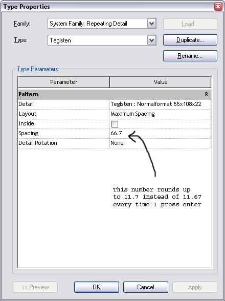

Hi all.
Is there a way of making a parameter value more accurate than just one decimal, so it won't round up from 11.67 to 11.7...
I'm having problems making a good repeating detail cause of that inaccuracy.
Fri, Nov 2, 2007 at 5:31:19 PM | Parameter value rounding up.
lassep
Joined: Thu, Jun 21, 2007
6 Posts
I figured it out myself I changed the Project Units Format >shortkey:UN< to be rounding at 2 decimal places, and then I was able to use the 11.67mm in my parameter value. To avoid the dimension to have 2 decimals, like 1120.00mm , I just edited my dimension style to not use project settings for units format, and used 0 decimal places for rounding. Then my dimensions were nice again without the .00 in the end Hope this can help someone avoiding the same problem...
