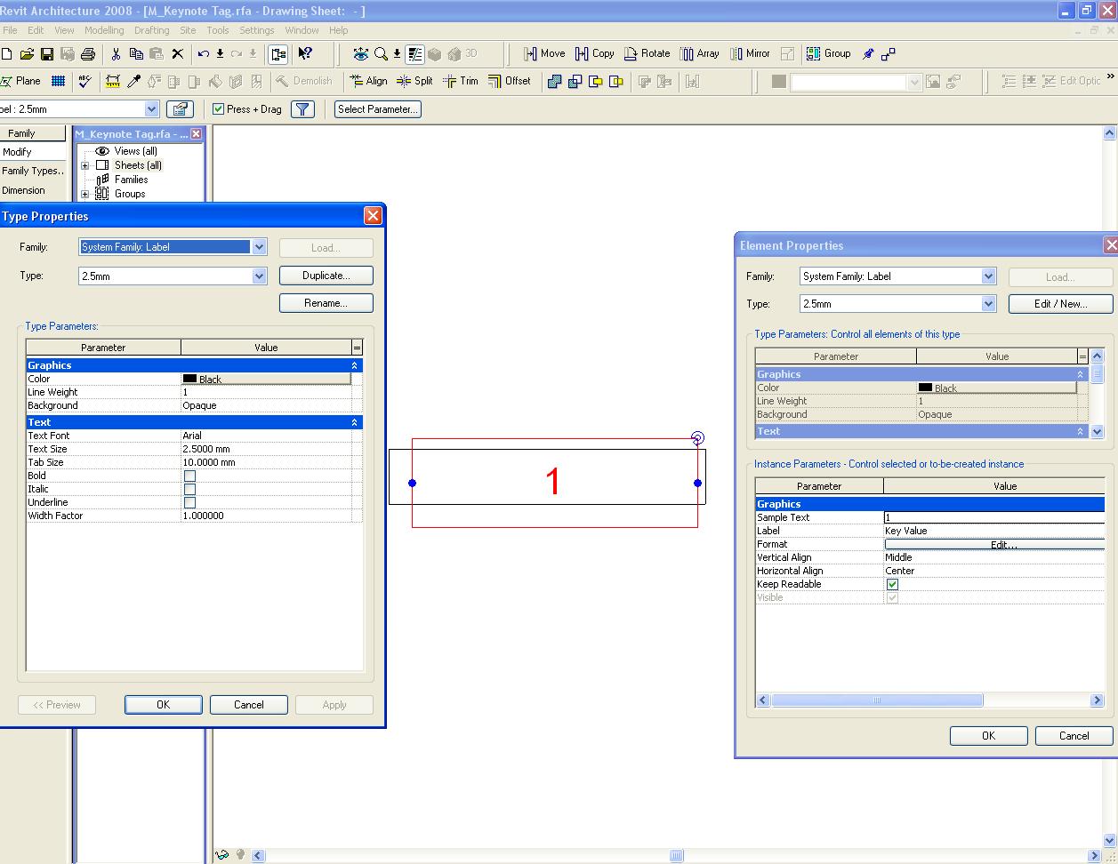

Wed, Oct 31, 2007 at 10:34:02 AM | Keynoting and Fill Patterns
torstenk
Joined: Tue, Oct 2, 2007
28 Posts
Im really trying i cant figure it out
 I can not go further than this:
See the picture
Wed, Oct 31, 2007 at 12:07:08 PM | Keynoting and Fill Patterns
#9
What you need appears to be there in your image, you just don't recognize it.  You say you want to change more than the width - that you want to change the top.  That sounds like you want to change the text height.  The text height is controlled by the text size listed in the panel on the left in your jpg.  If you want to change that though, I suggest that you rename the text from 2.5mm to the text height you set.
Also on the left is the text proportions which is set by the width factor.  The 1 indicates the text is full width of the initial text design.  The actual width of the text per line of text is controlled by the two blue dots at the endso of your text panel.
Thu, Nov 1, 2007 at 4:32:19 AM | Keynoting and Fill Patterns
#10
torstenk
28 Posts
Yes but the problem is i want the same text height. I just want to make the labelsize bigger so i can fit more text into it. Thats the real problem. And the only way i can get more text into it, is by making it higher. But i cant see how that is done?
Can i fit more text into it by changing the width factor?
