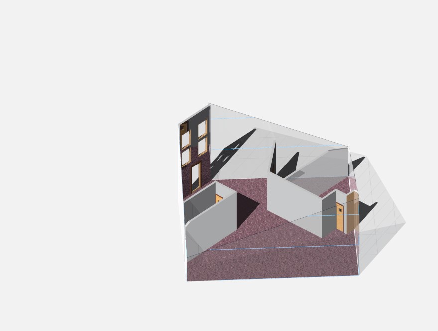

I need help modelling a roof for this building. PLS help. it's supposed to be a parabola like catalano's recently destroyed house in carolina. Post edited on 2005-02-17 14:04:28

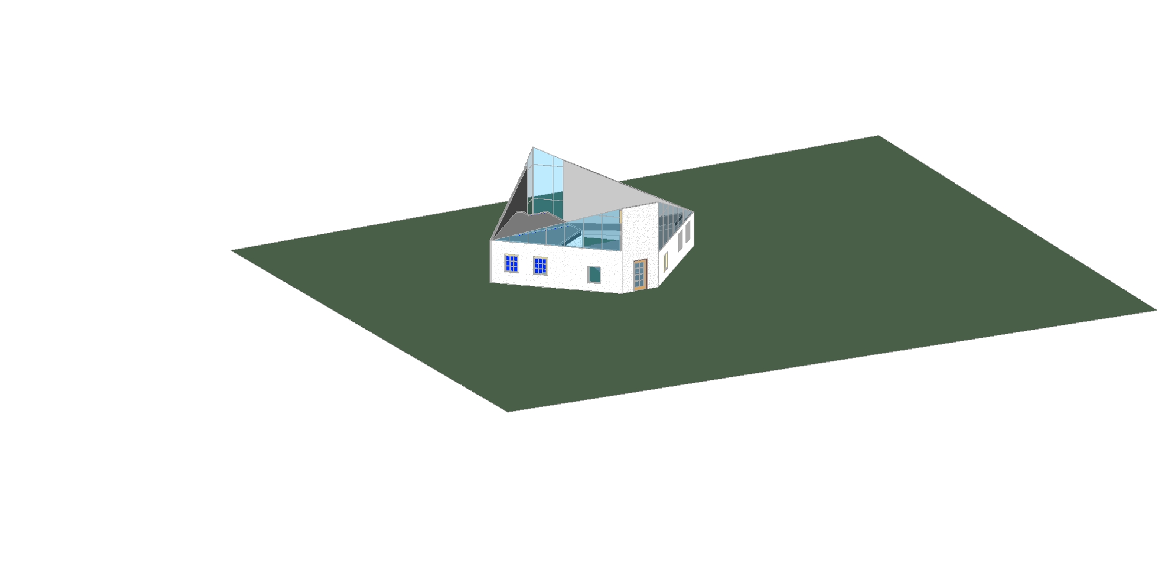

here's a better rendering

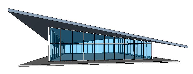

Using a blend is how, see attached
