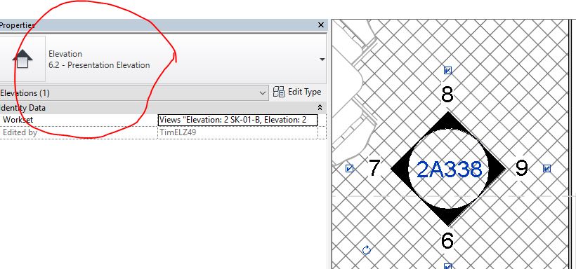

Fri, May 18, 2018 at 9:39:23 AM | Combining Elevation Tags?
tim123
Joined: Tue, Apr 12, 2005
1310 Posts
4 Stars: 19 Votes
Perhaps I'm misunderstanding - just change it to the right type.
