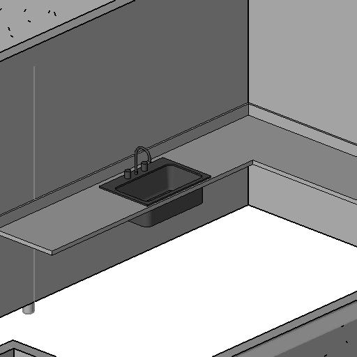

How is everybody drawing countertops? I found a few families that are baiscally just sweeps, but then I have to create a new family for each condition (L, Double L, Reverse L, U, etc.) I am also having problems punching holes in the countertops.
Would it be best to just create a profile family and just do sweeps inside of the model? If so how do you get that sweep to live in the casework object styles (so that my filters work)? And can you punch holes in a sweep?
For right now I just got frustrated and am useing a 1.5" thick roof.... it works but isnt in the right object style or material which poses a problem for our estimating department.

I've tried various methods from using floors or roofs, to in place families and found that the sweep profile works best for me. Creating the in place sweep from a predefined kitchen or vanity profile under the "casework" category should still maintain your visibility criteria. Set it at the proper height and place your sink at the proper height and cut the void.

Dogfrey:  how do you add a void/ hole to a  sweep?

(Dogfrey:  how do you add a void/ hole to a  sweep? )
Select sweep:EditConfusedoid FormConfusedoid ExtrusionSadi usually tab the border of the sink which creates the boundary)Set extrusion properties(if counter is set vertially at 3' and is 1 1/2" thick, set void for 3' start, 2'-10 1/2" end):Finish sketch:Finish family. No need to cut geometry.
The problem i had with the pre-defined counters was always tweaking lengths and opening positions/shapes, not to mention the doglegs and chamfers but for simple 'L's and straights, they work fine.
