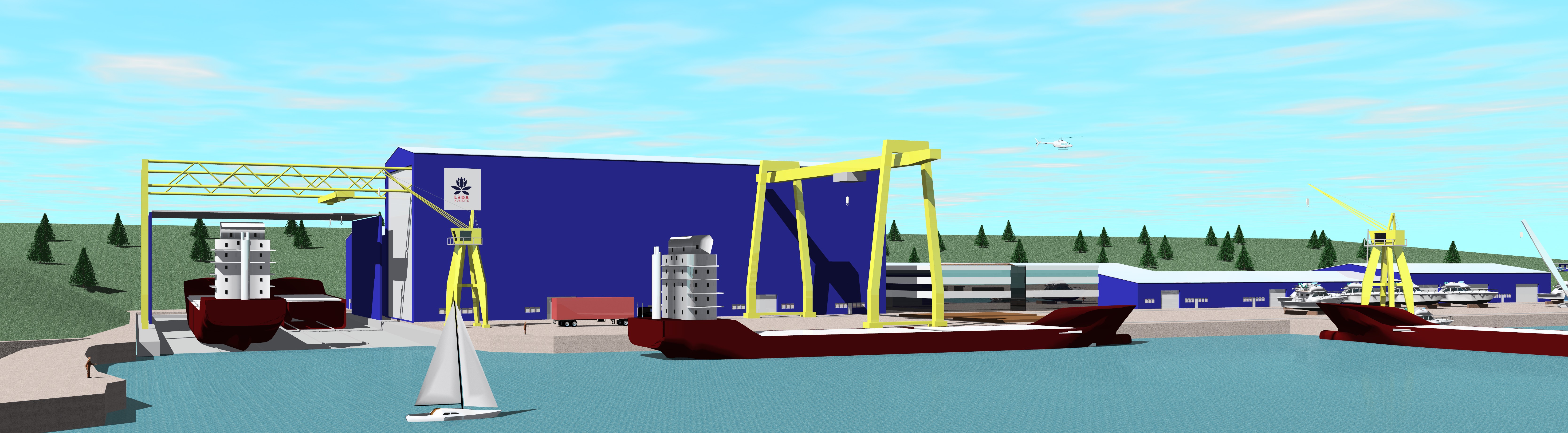

Hello,
 At the moment we are making a presitation for an shipyard. The problem is we can`t find any shipyardcranes, forklifts, big seaships. We got an 3D CAD boat but if we start rendering it becomes gray and even if we give the shiplayers an material. So my question is does anyone knows where we can find these things or an solution for the CAD ship problem? Website`s where we can find these things (also sites where you have to pay) I hope you peeps can help us.
 Greeting Mark Vegter

you can find many 3d DWG models on the net, you can assign materials to different layers of the DWG,
go to Object styles and to the Imported objects tab, your dwg will be there, expand it's listing and assign materials...

if you need more info on what eldados was was refering to, take a look at this tutorial
http://www.revitcity.com/tutorials/how_to_grow_your_family/

Thanx guys it worked out perfectly.
