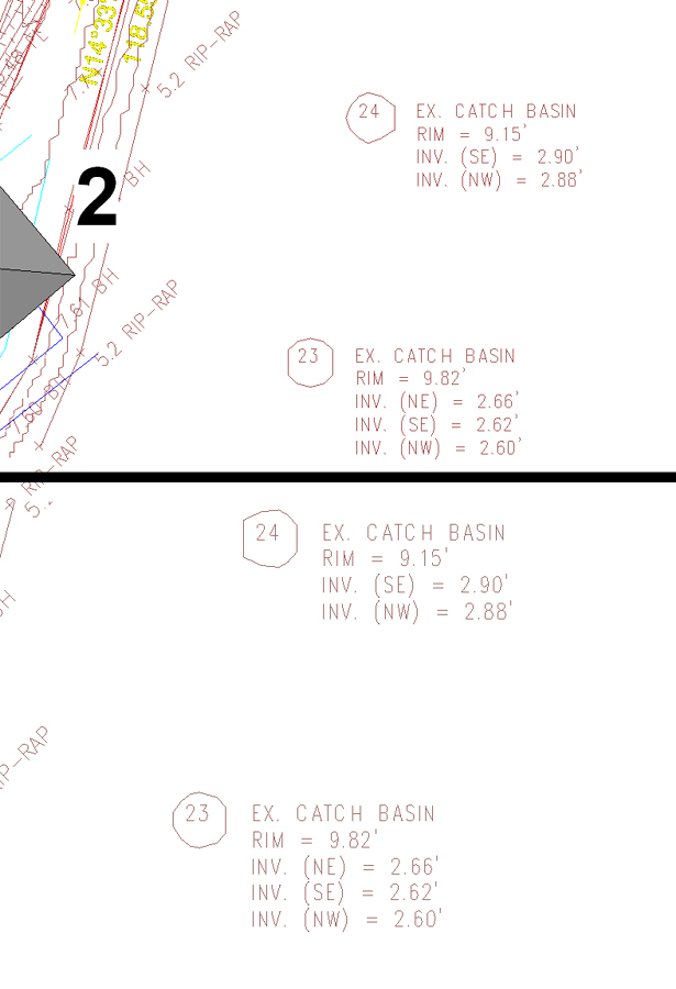

I'm trying to import a site plan from Autocad 2008 into Revit and am having some really strange behavior.  The imported file's resolution is terrible and changes depending on the zoom level of my screen.  I've tried changing everything I can think of with no success.
See the attached file for a quick example - look at the (supposed) circles around the numbers...you're seeing the same exact area - one image is slightly zoomed in from the second.  File is a normal Autocad vector file and displays perfectly there.  If I query one of the pieces of linework, the "highlighted" geometry shows up normally, so it seems to be a display issue.  I also tried plotting and it plots as it displays....

Sounds like the 2 mile error...  If the co-ordinates of the imported file are a long way from the origin then there is a truncation error that occurs causing the lines to display strangely.
Everything you draw in Revit needs to be located with an imagine 2 mile diameter (1.6km radius) circle around 0,0 to avoid this issue.  Try editing your DWG file to reset 0,0 to a localised point near all the detail.

Mr. Spot is correct....get everything closer to 0,0 and it should work - at least it did for me.

My spider senses (and 20 years of the DWG) are telling me that something in that civil file if off on mars. It would not be the first time. In fact it's the norm. Who knows the history of that file and how many unskilled hands have been into it.
A frozen / off point or node in a nested block etc. etc. Just because you copy and paste to a new file does not mean that something you selected does not have an entity that is on a layer that is off or frozen that is far away. Civil files are imfamous for having phanton objects off in space. It can drive a man to drink !
As an experiment do this.
Open the DWG file in AutoCAD that you already cleaned up, flattened and purged
SAVEAS a new name
in model space, thaw and turn on every single layer and then regenerate
explode everything (use the 'ALL' selection method) until there is nothing left to explode and then explode once more just in case
then do a zoom extents
See what you get ! If you see nothing there's your clue.
Chances are something is WAY out there. Then you need to find the phantom objetc(s) identify what it (they) belongs to and fix the problem.
This is an interesting predicament because if this is the case you will need to have expert AutoCAD skills to actually solve a REVIT problem. As in, if the experiemnt above does prove there are 'far away objects' that only explains the behavour in REVIT but then the work begins to actually resolve the DWG problem. So then I would conclude that each architectural office, even if 100% REVIT based, still needs to have a resident DWG expert on hand. And I mean expert, not a novice user.
