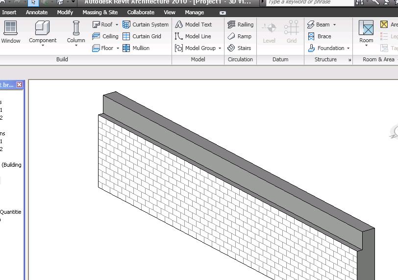

I'm trying to add a stone wainscot to a wood exterior residential wall with stucco above.  Do I have to use wall sweeps to do this or is there some other method to create a wall type instead?  If I have to use a wall sweep, how do you create a custom wall sweep?  Thanks!

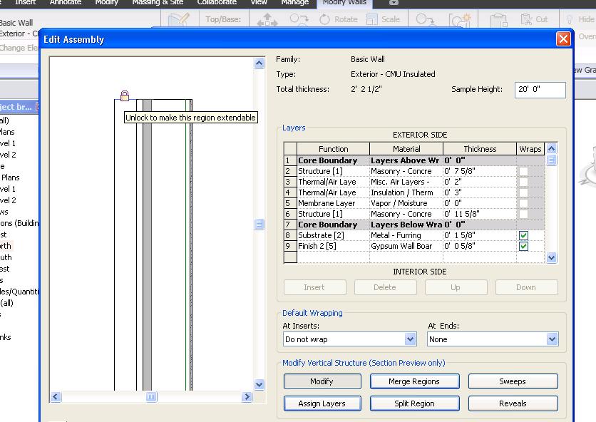

Click modify in Edit wall structure and select the top of finish, you will find a lock. just unlock it. Then in the Element Properties of wall just give required value for Top Extension Distance. Check the attachments. The solution is in Revit 2010, if you are using lower version then you have to drag the finish manually. Hope this helps.

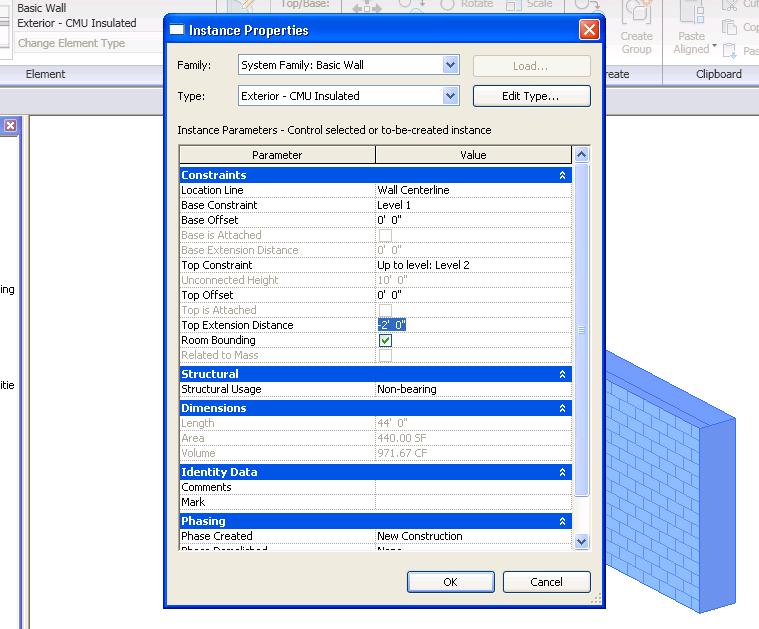

Thanks, but it's still  not working.  When I go to Instance Properties dialog box, the "Top Extention Distance" is faded out and won't let me put a value to it.  I'm I missing something else?

Hey First you have to unlock the top of finish layer, Check the attachments of my previous post, in the first image, click on modify then select the top of finish, you will find a lock. just unlock it. Then go to Instance Properties dialog box, the "Top Extention Distance" is now highlighted. Enter the desired value.
