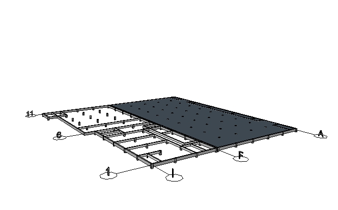

Properly you can try model text...It is a long shot but it should just work to your extent..
refer attachment and this link to my previous thread issues as well http://www.revitcity.com/forums.php?action=viewthread&thread_id=8949, the following image is the workaround..
btw, never knew that we can insert text in 3d view, thank for the tips & Good Luck.
