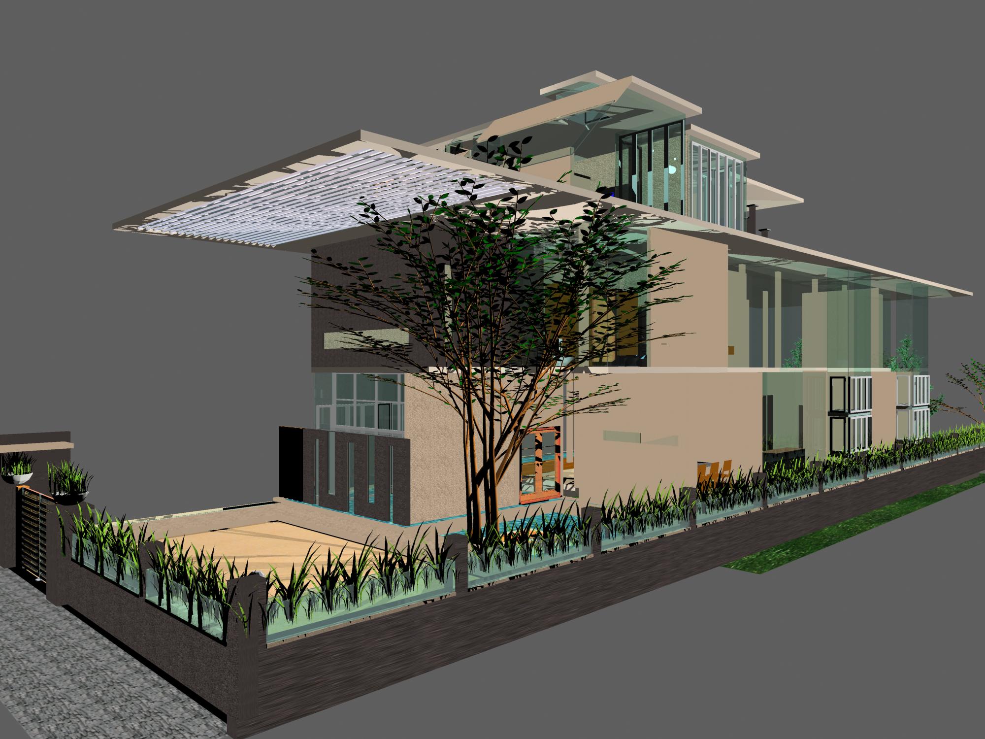

Thanks for reply. I have tried to export it to viz, but I cannot get the effect i have on revit, mayb I am not familiar with viz, cant seem to get what i wanted after many renders, enc. an image rendered in viz after i export it from revit, and import it in viz, pls comments, thks

Yhea, there is no point in sending it to viz if you don't know how to use it. Viz/Max can be complecated. one thing that will imediatly improve your image is to make sure the background is white instead of grey. sorry can't really get into all the different options in viz that may help you as it would take too long.
