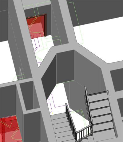

I have walls meeting at a 45 degrees angle. In the case they do not join in a clean way I join the geometry and in most of the cases it works, I get a nice and clean wall joint in plan view. please notice that walls may not be linked to the same level at the top but surely intersect for at least 1 floor. I keep workingon ather parts of the building and sometimes when I go back to the same plan view I have to fix the same problem with the same walls again, as if revit just forgot about it. What am I doing wrong? Thanks.

Tue, Feb 15, 2005 at 9:33:24 PM | RE: wall joint in plan view - pic attached
aabrmn
Joined: Fri, Feb 11, 2005
83 Posts
here is a pic of a typical case

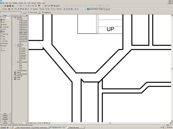

Wed, Feb 16, 2005 at 10:49:40 AM | RE: wall joint in plan view
aabrmn
83 Posts
not working

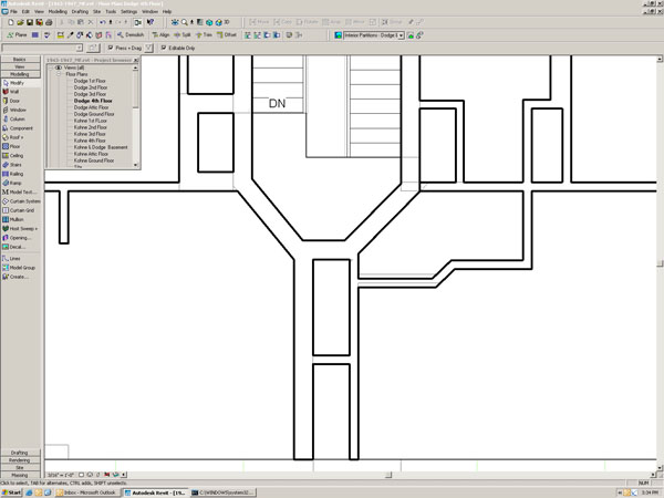

Wed, Feb 16, 2005 at 10:50:01 AM | RE: wall joint in plan view
aabrmn
83 Posts
working
