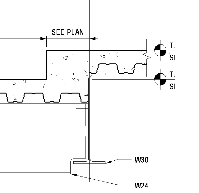

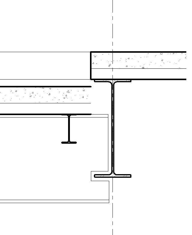

Hello all,
 I am attempting to create a depressed concrete slab in a composite steel deck.  I have attached a picture of my desired output and what I have in Revit so far.  I have attempted using the edit edges tool but I always get extra lines in places where I don't want them.  If anyone knows of a tutorial for drawing details mostly for Structural dicipline it would be appreciated.
Thank You

I would probably do this as two slabs.  One with a hole in it.  Because the top of the lower slab is lower than the bottom of the top slab, I would propably use a edge sweep here to join the two then use join geometry to clean it all up.
Seems kind of messy - maybe someone else has another idea.
