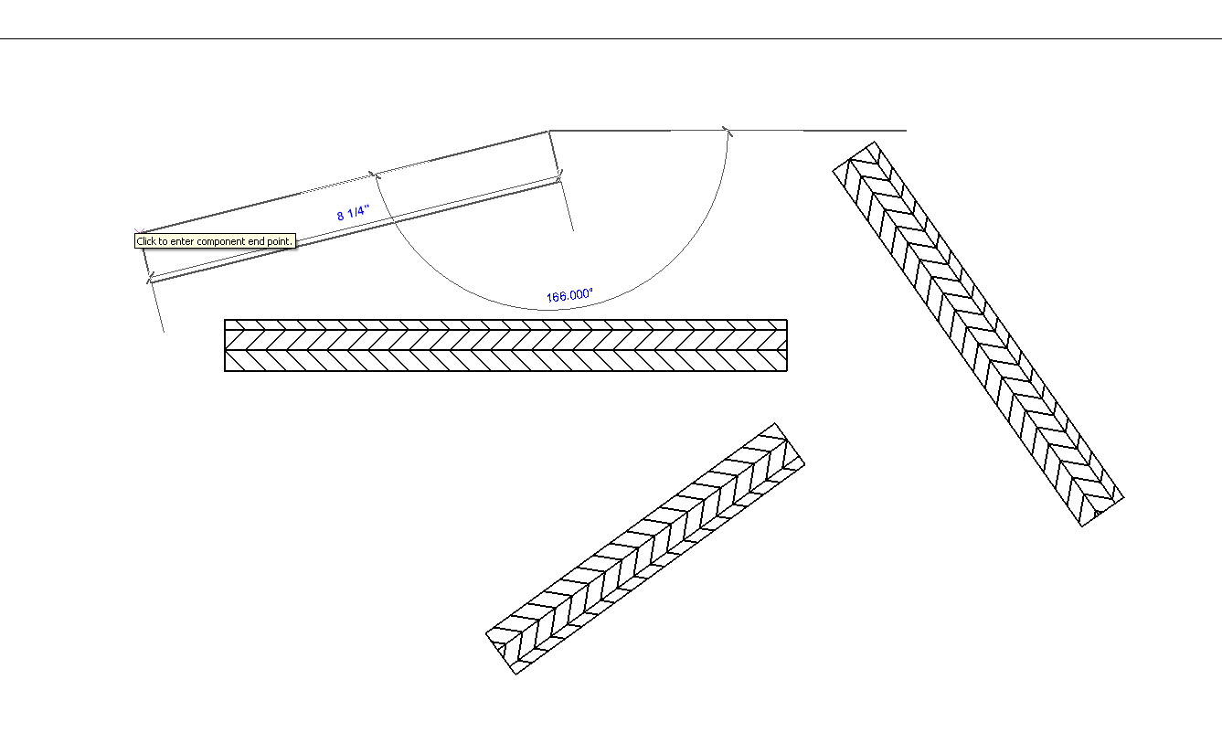

Open the plywood-section detail component in the imperial library. Edit the existing fill making it a model fill. You'll have to create a new model fill. Use this hatch pattern as the .pat file that you import as custom. Use an import scale of .2 , then save it.
 NOW which ever way you draw the sheathing the plywood pattern will stay aligned.

Clinard,
Followed your instructions and created a filled region with a model Fill Pattern able to rotate any way I want.

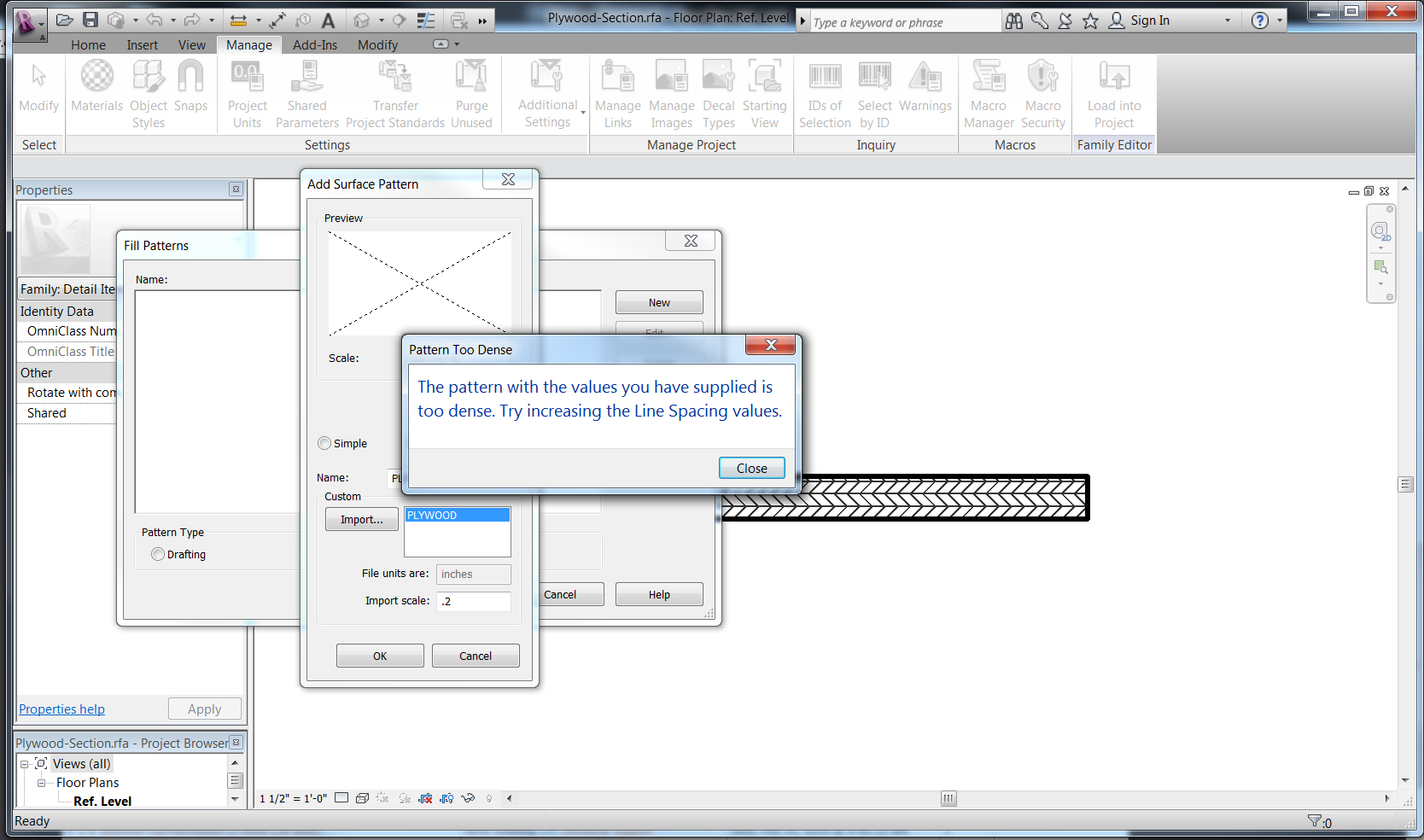

Thu, Nov 24, 2011 at 12:37:18 PM | vertical plywood
#11
JST000
JST000 Avatar
Joined: Thu, Mar 1, 2007
17 Posts
I can't get the scale at 0.2 it give me this message (see attached screen shot) the smallest scale it will let me use is 5, which is way to big.
Any ideas on how to fix?
Fri, Nov 25, 2011 at 8:04:30 AM | vertical plywood
#12
How small are you trying to make this pattern?  It becomes a solid when it is too small.  This pattern is for detail views, not small scale views.
Fri, Nov 25, 2011 at 8:26:44 AM | vertical plywood
#13
JST000
JST000 Avatar
17 Posts
Just trying to use it for scales of 1 1/2"=1'-0" and 3"=1'-0". For detailing.
