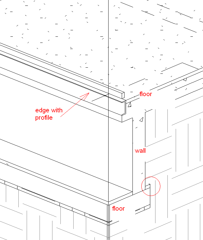

Dear All,
i need to create this type of floor edge without using in-place-familly. Is it possible?
Currently, i create in-place family with void to provide a shelf on the floor slab and add a floor slab edge.In the case the bounding profile changes, i need to re-edit all instances.
The image is attached. Revit Architecture 2008.

I would do a floor edge sweep for this.  The profile can be whatever you want.   I use a floor edge swep to add perimeter insulation to my ground slabs.

it is edge sweep already, the question is how to create a bottom part together with the sweep. The floor structure does matter - it's wor working drawings.

The floor & wall you show below your slab can be an "edge sweep"
