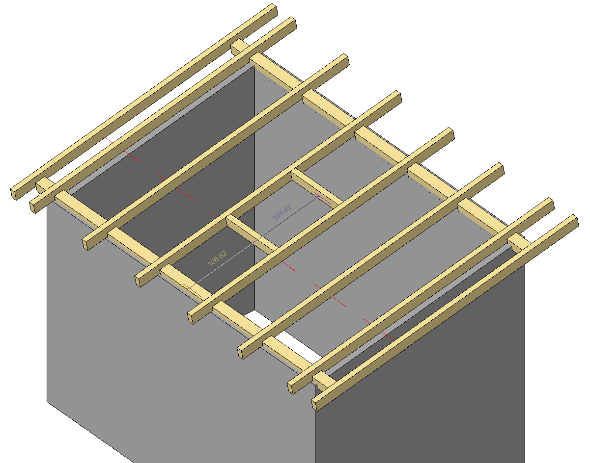

Is there a way to create a rafter roof with exposed rafter tails for the overhang?  Just curious it would be a nice feature.

use sloped glazing and empty system pannels Winking

g,day lorne 17 , check out the article on
http://revitandstuff.blogspot.com/2006/11/sketch-revit-trusses-as-railings.html
 this might be what u are after.
