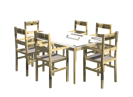

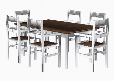

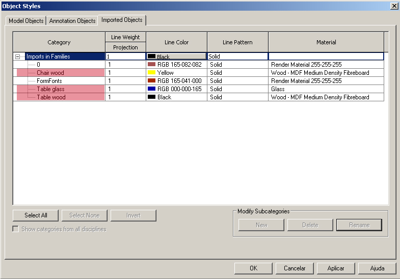

The thing is... When I import a DWG file into a Family, and try to change in the Object Style the materials of the layers that I separated in AutoCAD, something happen and it all goes wrong. The chairs were supposed to be made of wood, and the table would be wood and glass. But like the picture I've attached the table is metal and wood, and the chairs too. I've attached also a window of the Object Style so you people could see that the settings are alright.
This have happened to other Families too.

Well, I think I managed to solve this...
I've exploded again the blocks in AutoCAD. First it was 8 blocks (table, glass and 6 chairs). Now there are hundreds of them (polygons).

This looks like it should be two or three families.  A chair, a table and possibly (but I don't think it should be) a family that has a table and 6 chairs (I would rather see this as a group).
Don't! explode your block in REVIT.  Instead, seperate your blocks in AutoCAD into two files - chair & table.  The blocks (chair & table) should be exploded but not the meshes.  Make sure the individual elements ... leg, top, cushion ... whatever, are each on a layer which you can then assign a material to.  IMPORTANT CONCEPT - Watch out for nested blocks.  REVIT wants to assign materials based on the element's layer.  What layer is a nested block on - its inserted layer or the layer the block was created on?  REVIT doesn't seem to like this.
Now you can insert the AutoCAD dwg into your family. (PURGE ALL UN-USED LAYERS FIRST and make sure you save with your current layer being one that you are using.)
