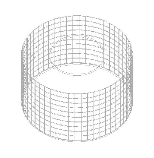

MIra este es parte del archi, necesito conectar la parte superior del muro con  esa piso mas pequeño, si me puedes dar tu correo o msn te lo agradeceria el mio es guano_guano@hotmail.com

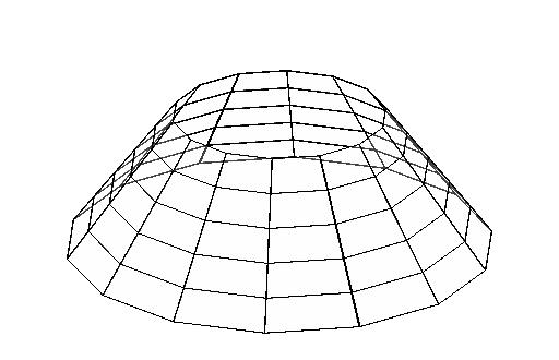

Hi Pacho
this is what you can produce using the massing tool creating a blend and then using the curtain system tool in the massing tab to convert the faces from the mass into curtain walls I hope it helps Smile
