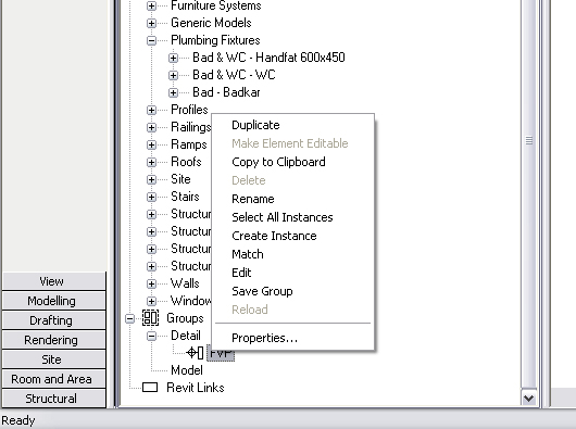

Does anybody know how i can delete/unload group that are loaded into a template file.
For some reasone i cant delete a group that i stuck under groups/details in Familiy explorer.
What to do?

You should be able to right click on the group in the project browser and chose delete from the right click dialog.

Allright,
But something is wrong, the delete option is not possible.
(look at the screendump, i uploaded)

There is an instance of the group somewhere - try Select All Instances to find it.

YYEESSSS!!!!!
It worked!!  Thanks a LOT!
