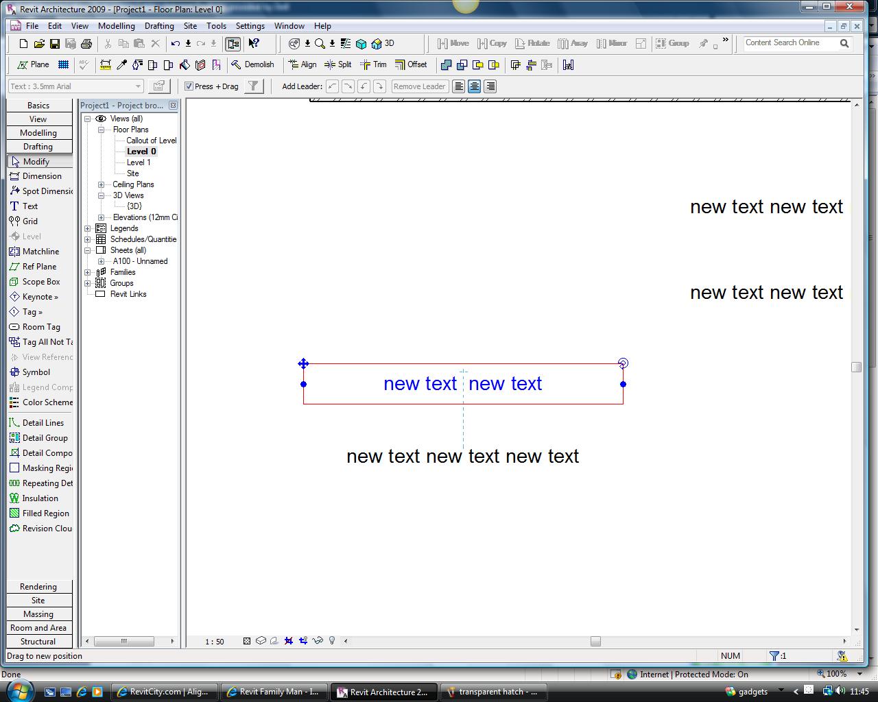

It depends on the text that you are referring to.  Normal text snaps to align with other text with the same justification.  Click on the text and move it using the drag symbol.  The text in the image is centre justified, so snaps to the centre of the text below.  If it was left or right justified it would snap to the relevant side.
