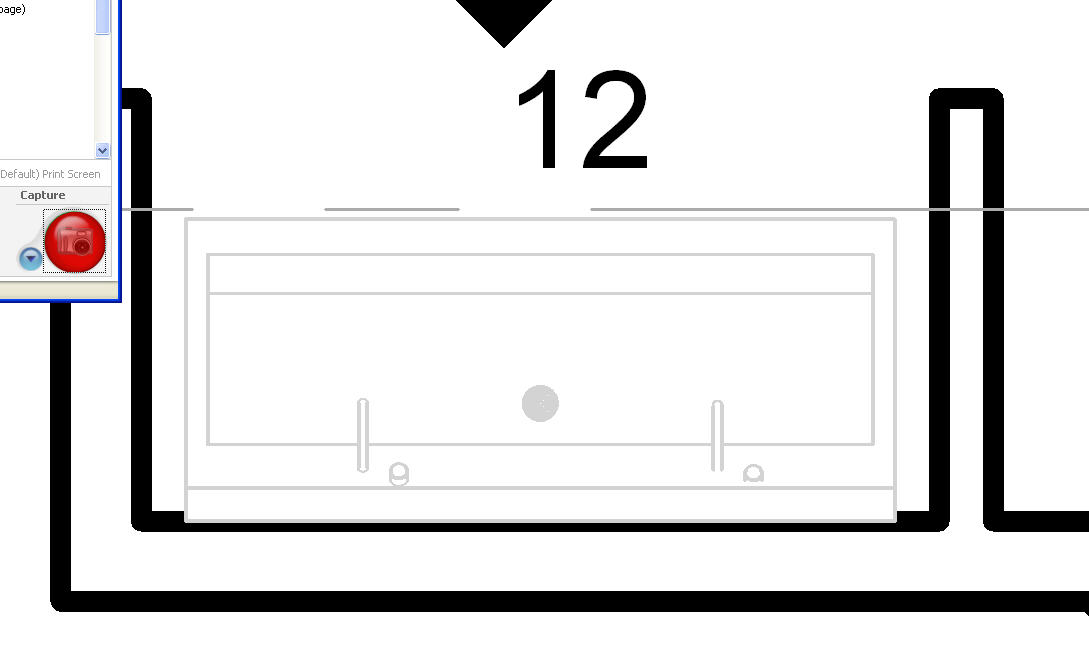

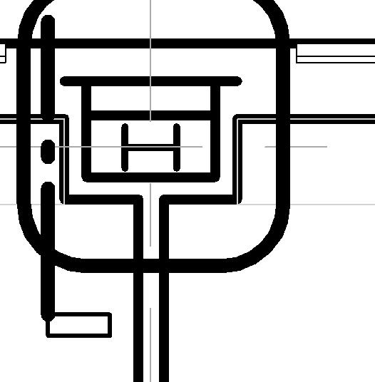

Hello again. I cannot figure this one out. Here is a screenshot of my problem. Is there a hierarchy of objects list somewhere or a draw order  command out there that I can use to control things to be in the "foreground" and "background"? I am not specifically talking about images and autocad files as those are no problem. Native Revit items are causing me the most trouble. Notice the gray thin line on top of the black thick line in the first example pic. The second pic shows a component "hiding" a portion of the walls thick black line. I really do not want to have to go into all of our families to do a fix if I do not have to.
Thanks in advance,
JQ

Hi, the solution I've came up with is to modify the line weight of the wall line that appears under the component using the line weight tool, and selecting the proper line type in type selector. The images attached explain better then 1000 words.
Hope this help you a little bit.
